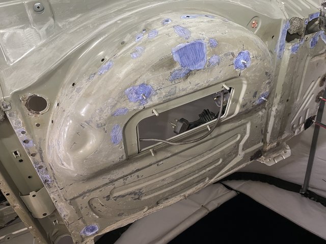

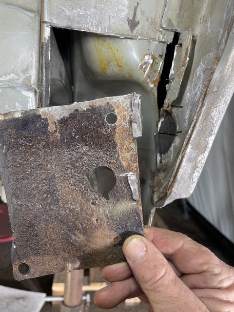

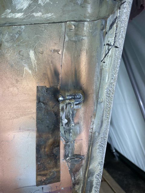

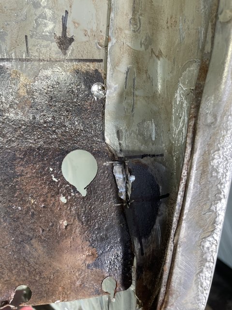

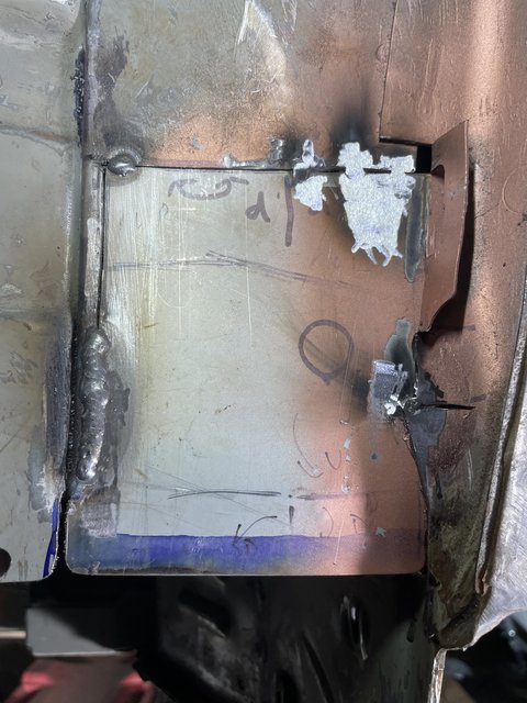

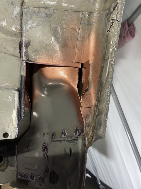

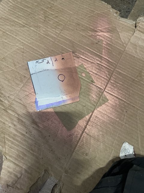

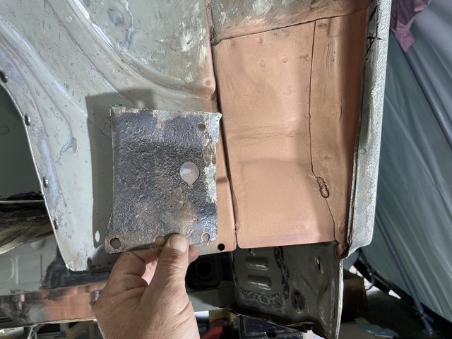

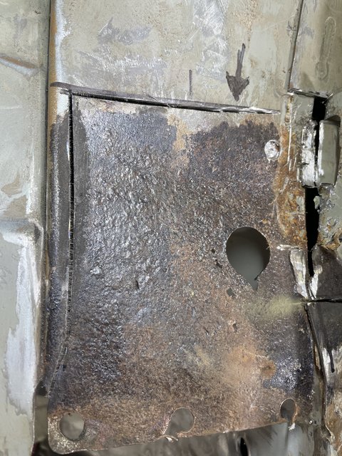

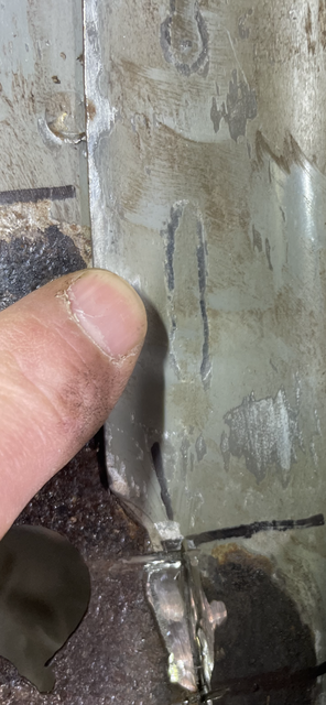

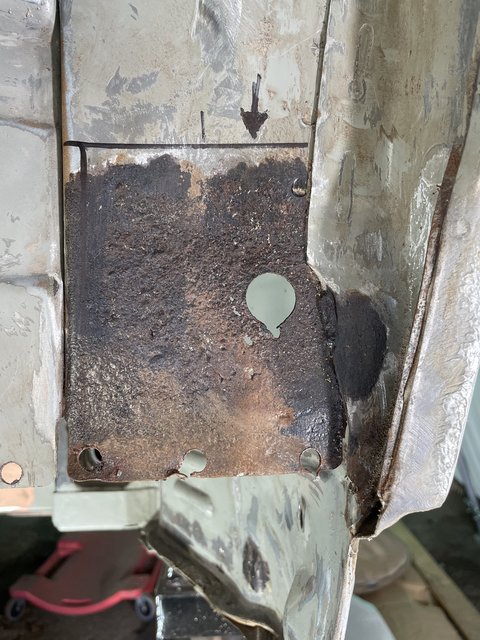

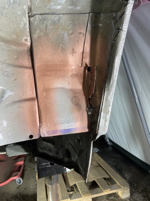

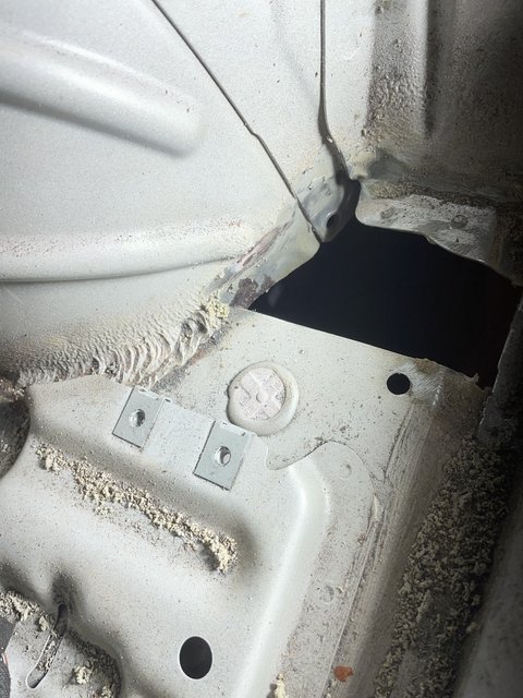

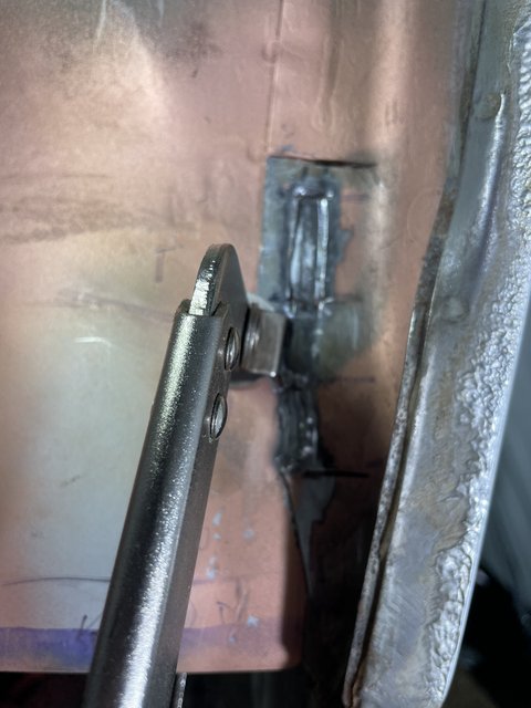

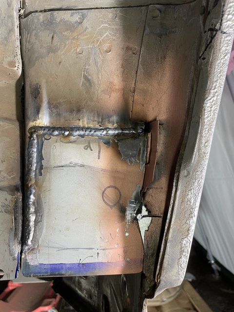

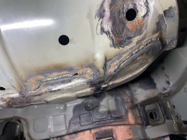

Where were we? Oh yes I remember, I was doing that bit in the wheel well the other day when I was tempted away by Italian food. I found my paper template in the shed and traced round it onto some 1.2mm steel. I made it a bit wider on the right hand side to allow me to weld it from the front, where it was originally done from the back. You can see that it goes further through on the right than the existing bit. It looks like it is a flat piece of metal but there are a few creases and bumps in it, which I copied from the old one. Once I was happy with the fit it got a quick squirt of weld through primer, I did the back and the bit where it will be covered by the overlapping piece at the front. I also put a bit on where the plug weld will go. It was then ready to tack into place. I grind the tacks down so I can weld straight over them without creating a large bump. A quick tickle up with my fancy new power file. Then it got another squirt of weld through before I folded the other piece back down on top of it. When I folded the other bit back down it didn't want to sit flush because of the springiness of the metal but I could just reach the bottom part with a clamp. Once it was tacked I could tap the rest down and weld up the slits I had to put in it to create the fold. I used a bit of copper to get a reasonable edge when I welded it. It all ended up ok. Here it is compared to the old bit. It took me all weekend to do that. At this rate it will take me another two lifetimes to finish it. I know I'm not the fastest in the world but I'll be glad when I'm able to pick up the pace a bit more. Cheers.

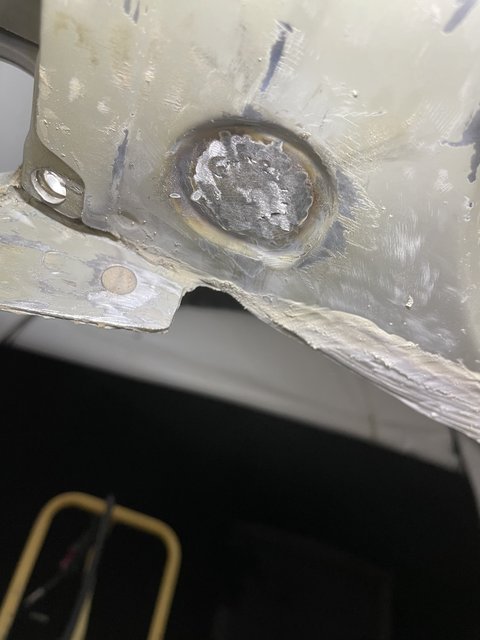

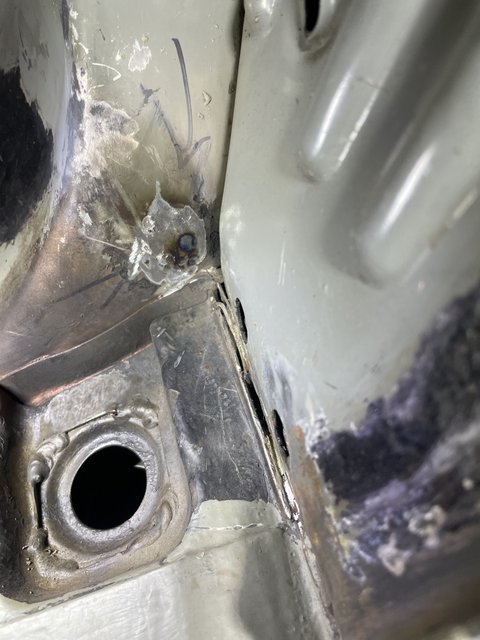

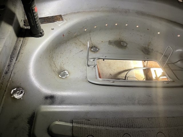

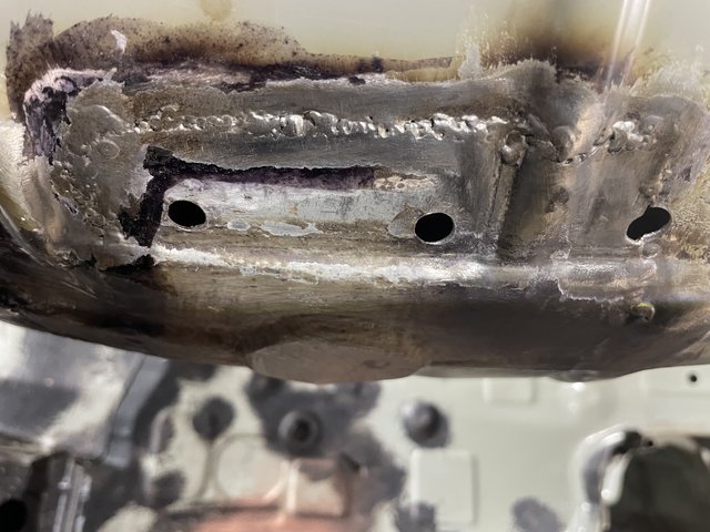

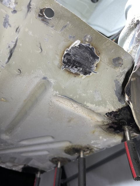

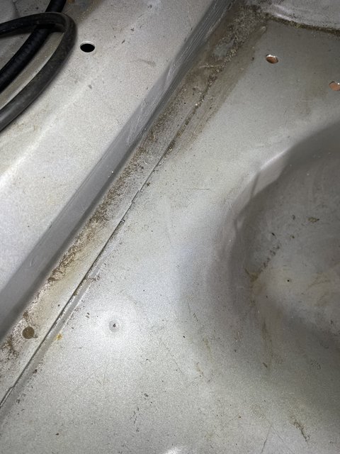

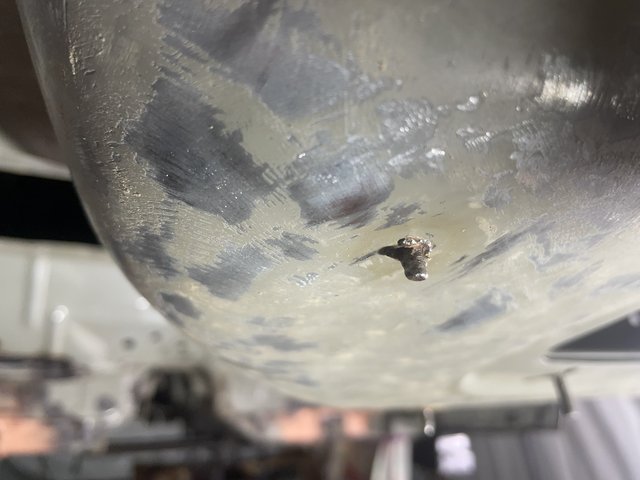

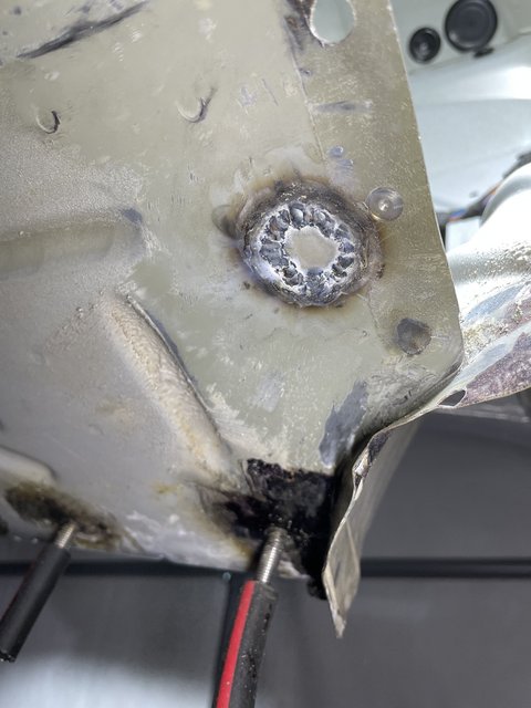

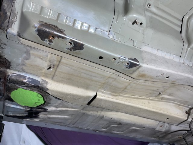

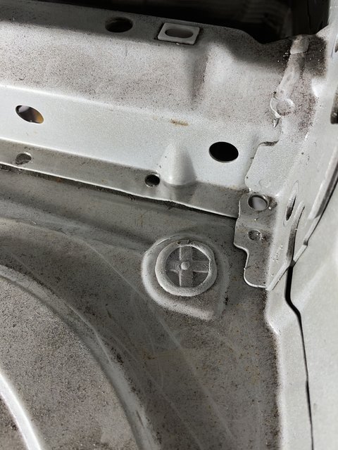

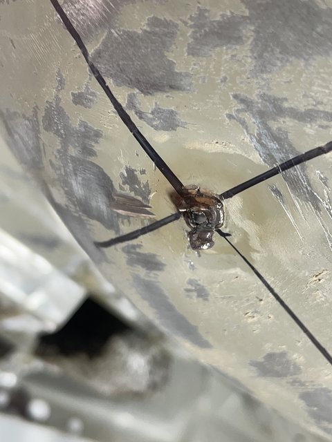

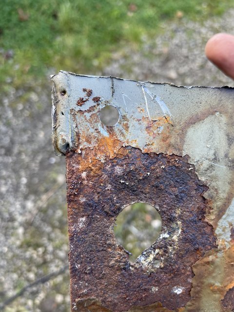

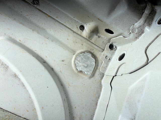

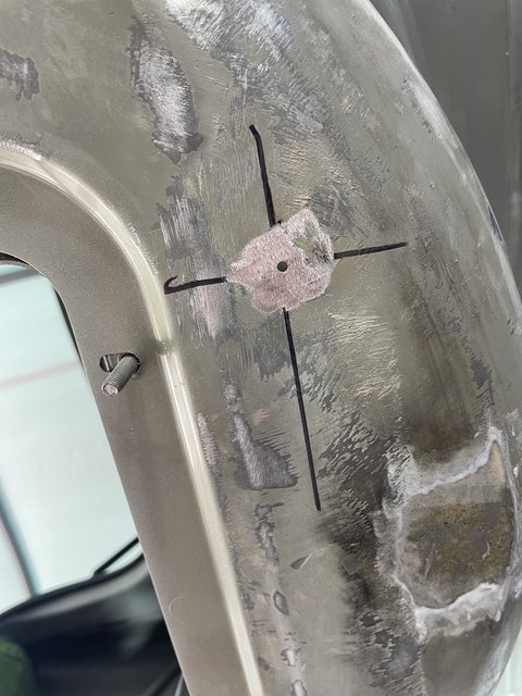

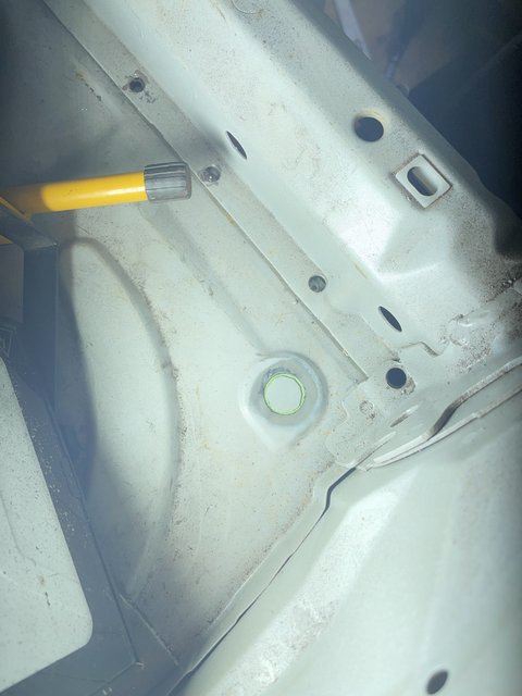

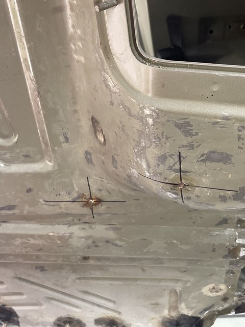

In the words of PC Dixon, 'Evening all'. I didn't do anything last night because I was late home, it was cold and tipping down. I was late home tonight too but it was dry and pleasant so I had a couple of hours whilst the Doctor took Fat Al for a walk. As you may have gathered I am obsessed with grommet removal. There are three left inside the boot which I haven't tackled yet. These three are surprisingly not rusted but I don't want to take any chances. This one is in the right hand rear corner near where the battery box is. Actually, the battery box is still in the shed but you know what I mean. See, it is pristine but the one at the other side of the boot wasn't so it is for the chop. I stuck a disc of steel in with masking tape. Sorry about the rubbish picture. I welded it up and gave it a quick go over with the power file, I haven't sanded it yet. The underside too. The next one is just behind the passenger side wheel well. It got the same treatment. The underside before filing. And after. I said there were three left but the third one will be above a closed box section once the axle panel goes in so it won't be exposed to the elements. I might leave that one in place, just to remind me of all this hideousness. Half way through the job the head strap on my cheap Lidl welding helmet snapped which was a bit annoying. I will have to repair that somehow. Another bl***y job! Cheers.

Looks great the work you are doing, really impressed with the panelin the wheel arch, couldn't tell it has been done, except no hole.
I am currently dealing with the rear floor pan grommets on mine, luckily no cutting/welding, just derusting and painting!
The BMW grommets I am replacing have a lip on one side and hot melt on the inside and are usual covered in underseal from factory, as mine won't be I am going to put them in upside down so the hot melt sealing on the outside, rather than having a lip to trap dirt/water.

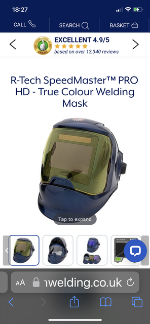

Funny that you should mention buying a better welding mask because I've been looking at these recently. Has anyone got one of these, are they any good? Friday turned out to be a very long day at work so I didn't get into the tent when I got home. I had to get some tyres for the Doctor's cars. I took all the wheels from the dogging car with me but I couldn't take the wheels off her Audi because she was using it for work, so I just collected some loose tyres for that. I was going to fit the Audi tyres this morning but the Doc had to go in to work today, I will have to fit them another time. I put the wheels back on the dogging car this morning so that I could go for breakfast at Ten Acres. I went to the creamy bun shop first but there was a huge queue and I could see that there were no large custard tarts left so I didn't bother to wait. This afternoon I thought I would do a bit more cleaning up under the floor to get it ready for painting I cleaned off the area under the rear seat then thought that I'd do a bit further forward whilst I had the tin of degreaser out. The floor along the left hand side of the tunnel, where the brake and fuel pipes run get coated with some stuff at the factory and it does a fantastic job of preventing rust but it is a swine to remove. I wish they had put it on the other side as well, that would have saved me loads of work. It is this black stuff. I went at it with a scraper first. After loads of applications of degreasing solvent and scrubbing it with a toothbrush and plenty of rags it came up like this. The bare metal bits are where there was surface rust which I wire wheeled off then they got some phosphoric acid treatment. I had had enough by then because scrubbing overhead made my shoulders really ache. In a stroke of good fortune, the Doctor called in at another branch of the creamy bun shop on the way home and she managed to come up with the goods. She didn't get me any Frosties because she said the price was absurd. I suppose we'll have to go out for for breakfast again in the morning. I won't mind that at all. Cheers.

R Tech thing seems good enough - Just looks like too many things going on with it for me - I use a welding mask for welding and googles and ear defenders and a filter for grinding. I think the inner and outer replaceable protective screen on my Lincoln are a fraction of the price and the Lincoln helmet weighs <600g
I can't justify over £200 (even with man maths!)for the amount of welding I do but I have noticed Screwfix do a large field of view one for £42 which I am thinking about.

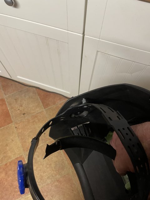

R Tech thing seems good enough - Just looks like too many things going on with it for me - I use a welding mask for welding and googles and ear defenders and a filter for grinding. I think the inner and outer replaceable protective screen on my Lincoln are a fraction of the price and the Lincoln helmet weighs <600g I know what you mean DS, but the R Tech is cheaper. I can't justify over £200 (even with man maths!)for the amount of welding I do but I have noticed Screwfix do a large field of view one for £42 which I am thinking about. I paid just over £200 for my Speedglas about 25 years ago which was a fortune back then and I have had a lot of use from it but I don't want to pay Speedglas prices now. Keep us informed if you get the Screwfix one. Anyway, as a stop gap I've borrowed a Sealey mask from work. I can get away with this for two reasons; firstly, I'm the only one who does any welding jobs at work and secondly, I have the welder from work in my shed at home... On Sunday the Doc and I went out for breakfast and when we got home she was going to shovel and wheelbarrow three tons of hardcore up to where her new patio is going (I've dodged a bullet with being injured so I can't dig) and I was going to go in the tent for a bit. I had just got into my work clobber when my pal Luke messaged me to say he was going in to work if I wanted to go and use his equipment to fit the tyres to the Doc's Audi, so I went and did that. I could get that job out of the way and still have plenty of time to go in the tent afterwards. When I was at Luke's the Doc phoned me to say that my pal Shultz had turned up. I arrived back home to find that Shultz had been roped in to the shovelling job with the Doc. When they had done that we spent the rest of the day gassing and drinking tea whilst the Doc watched the egg chasers on TV, so I never got into the tent in the end. Tonight after work there were no surprise visitors so I made a start on scuffing up the under seat and boot floor areas for paint. This is an incredibly tedious task. There were also quite a few suspect areas that had a bit of surface rust under the E-coat so I sanded those off completely. It doesn't seem like that long ago when I was thinking that it was almost too hot to work in the tent but it has definitely changed now, it was very cold and I had to dress up accordingly. I think winter is finally setting in. With this in mind, I didn't want to leave any bare metal bits overnight so I gave them all a going over with some spooge. This is what it looks like now, after two hours of sanding and scotch pad rubbing. There is still plenty of sanding to do before it is ready for paint and that hole next to the 'spare wheel well' needs sorting out. I can't just weld that shut because it is a wiring pass through, so I will have to repair it and re-drill the hole. That is a job for another day because I need to smother myself in deep heat and get up against a radiator to try to recover from the cold. Cheers.
