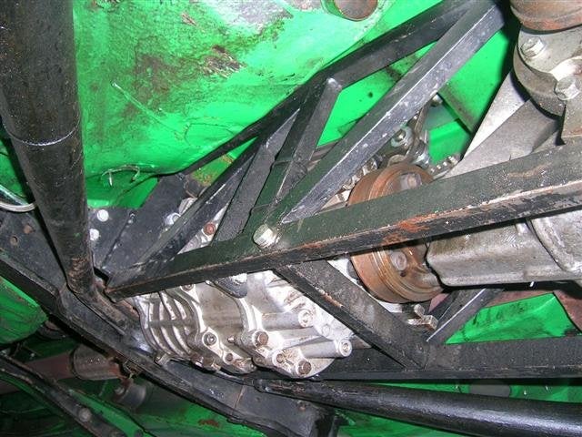

I've seen a BMW gearbox mated to a BMW diff once in the back of a E10 to make a transaxle.
I've seen similar with a Volvo 360 transaxle/separate diff thingy in a GTV6 in this thread. There's a full thread in Finnish I think here. ![](https://www.alfabb.com/attachments/nya_alfabilder_005-small-jpg.153014/) I expect that using a 360-style 'diff bolted to the output shaft of the gearbox' arrangement you could mix and match a different gearbox/diff combo and shove it in the rear (provided the clutch is sorted one way or another). Nowt wrong with a front gearbox mind, and they're much easier to sort for the torque you're looking at.
This is supposed to be a quick project 😅 i'm pretty sure i could fabricate something like that cradlemounted gearbox and diff but it would take more time, effort and money to do then simply using the box upfront.😉
Maybe in some future project but not this one.😉
