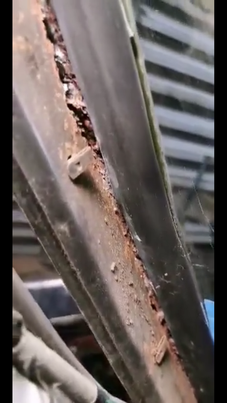

Today was started by investigating the rust on the A pillars which was worse than hoped. This was in part due to a damaged drain pipe that had had metal repairs previously but had not had the pipe repaired. Soon. This happened

Is that the sunroof drains you are referring to?
Mine seemed fine around the screen but then its a base vogue so doesn't have a sunroof.

I am about to pop the screen out on mine as the surround looks a bit worse for wear. I have no sunroof so hopefully not as bad.
Aug 28, 2020 17:29:29 GMT
Thats scary to see! It rally had rotted away quite well

Is that the sunroof drains you are referring to? Mine seemed fine around the screen but then its a base vogue so doesn't have a sunroof. Yep, sadly as with many older cars the sunroof can change from a blessing to a curse when they get blocked.
I am about to pop the screen out on mine as the surround looks a bit worse for wear. I have no sunroof so hopefully not as bad. Good luck with yours, by all means pop a picture up in here when you've done it to see how it turns out. Thats scary to see! It rally had rotted away quite well And this is one of the better ones! Seems to have been a London car for a fair bit of it's life which has helped.

Thats a very familiar sight. It it certainley worth saving and it looks like you have getting it all done properly. You will be so glad you never sold it.
Dec 18, 2020 11:33:37 GMT
yep, could be the pictures of mine being done, looks a good quality Job.

Thats a very familiar sight. It it certainley worth saving and it looks like you have getting it all done properly. You will be so glad you never sold it. Thanks! I hope so, should be back in use for January/ February hopefully and I must admit I am looking forward to it. yep, could be the pictures of mine being done, looks a good quality Job. Glad you say that. Welding is something I donโt know too much about to be critical but I am pleased with what I see compared to other welding jobs I have looked at. Thank you. Very much of the mindset that if it worth doing we do it right and it is good for many years to come.

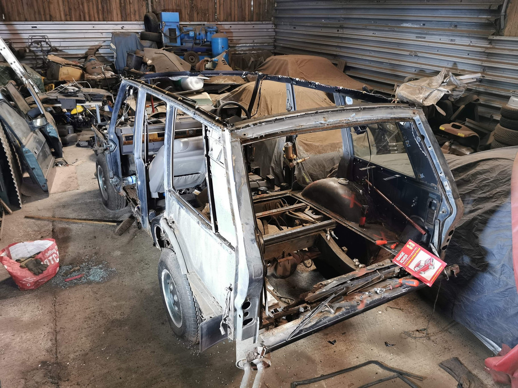

I am a little behind in updating this as Luke the Welder has been storming ahead with it recently.
Here is the progress so far.
New spare wheel well
Rear quarter on the same side. Panels are off waiting for paint. Rear cross member will be getting shot blasted shortly.
Same side, but up front. Has been so easy buying new metal for this compared to the Saabs.
Passenger footwell, floors, b pillar, wheel arch and more.

Jan 18, 2021 21:58:10 GMT
The doors and front wings are off to the paint shop tomorrow.
Annoyingly one of the window frames turned out to be beyond repair. Turns out JLR parts still do them new for nearly ยฃ300. Found one on ebay for ยฃ80 delivered.
Wheels are also off to be refurbed in their original Cypress Green. It's all start to get quite exciting now but I am daunted by all the fiddly little bits.
