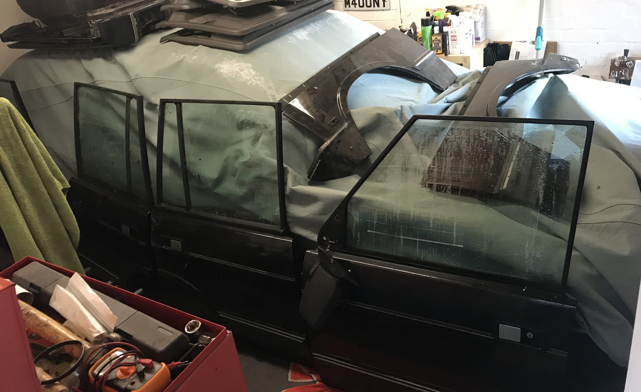

At this point the doors and wings had made their way to the paint shop. They paint shop guy had said that they were not as good as he'd hoped they were so I went about sourcing some more doors and wings. Found a nice guy locally who popped over one morning and dropped off this lot.
Am now running out of space in the house. Got wheels in the hallway. Two sets of seats taking up the spare bed room and doors/wings taking up the garage. The sensible thing to do appeared to be to start a new project with the door cards on the dining table.

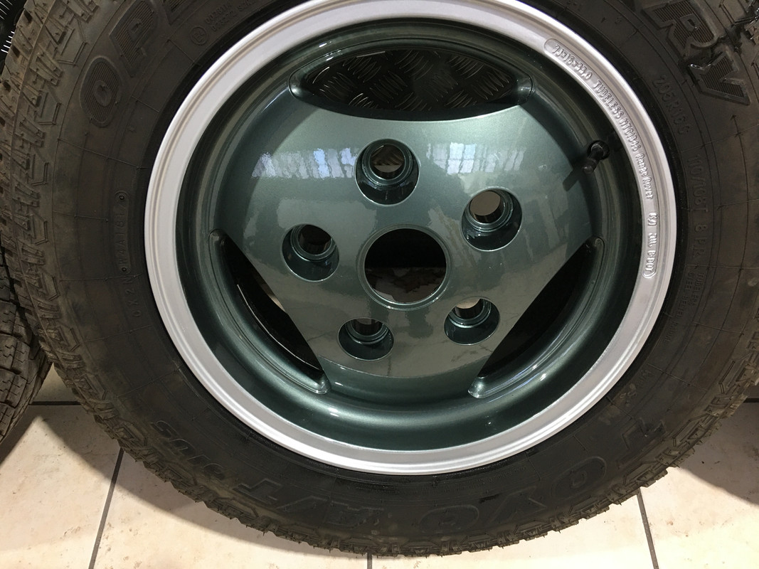

The wheels have now been ceramic coated, waxed and had new badges fitted. I think they're as good as I can get them now. With the car back able to be rolled it will be rolled across to the shot-blaster who will do the rear of the chassis whilst access is good. This is the only bit of the chassis that needs any attention. I also have built up the speakers in the door cards. Really pleased with these and looking forward to putting them in although I need to find someone to re do the wood veneer on a few bits.

Here are some of the doors ready for paint: The rear wings had all sorts of different paint on them and despite over a week in the tank it had not come off so they had to be blasted. The front wings have been stripped and are awaiting an aluminium welder to tidy up a few bits along the top of both sides.
