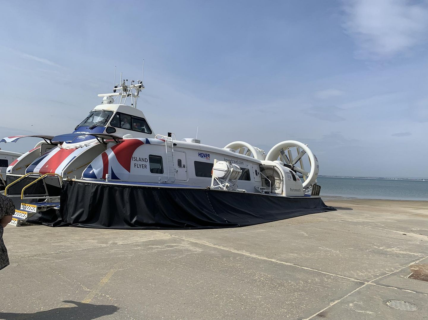

Pah, that's not a hovercraft, THIS is a hovercraft!!
