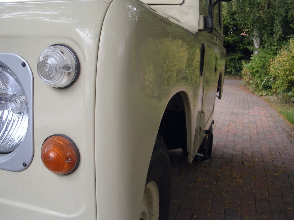

@grumpynorthener not to toot the trumpet, but i did this wing with HMG 1k synthetic, applied with microfibre roller, outdoors. yes there was a day in between each coat, and there were lots of them days, and lots of rectifying, and white is fairly forgiving, but you know, i took that comment as a challenge, i'm only sad that it is an old land rover lol

@grumpynorthener not to toot the trumpet, but i did this wing with HMG 1k synthetic, applied with microfibre roller, outdoors. yes there was a day in between each coat, and there were lots of them days, and lots of rectifying, and white is fairly forgiving, but you know, i took that comment as a challenge, i'm only sad that it is an old land rover lol  10/ 10 for effort from me
