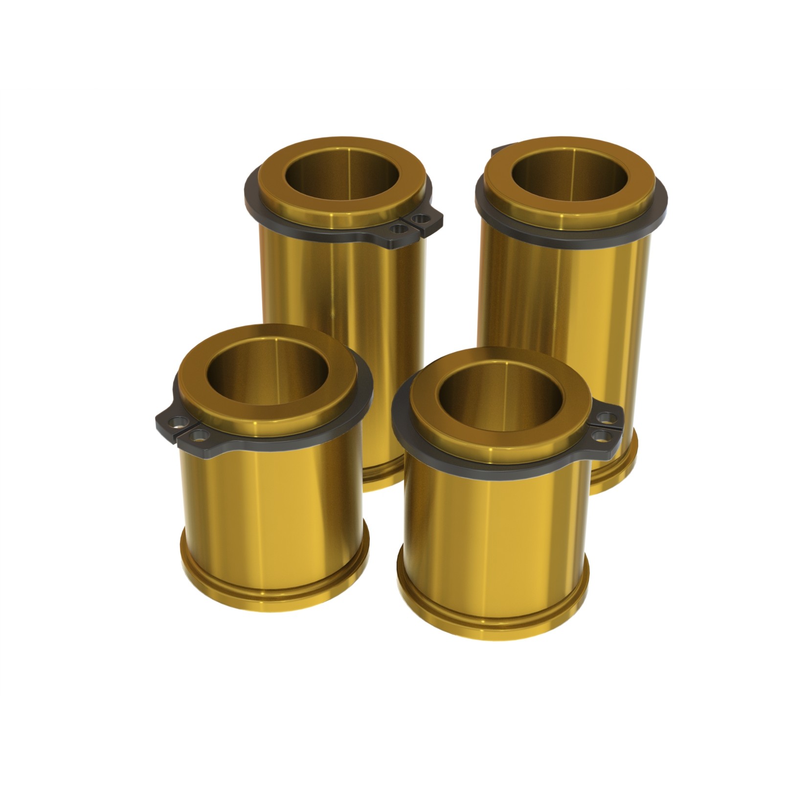

So, the 2CV has been getting alot of atention from me, with the M3 seeming almost as if it has been forgotten about! While I am driving it, this is not the case! Why? I had an MOT to get! It passed but the tester sucked his teeth a little at the rear tyres! They around 2mm. I know I know! I'm pushing my luck! But then the car isn't driven as much as it once was, and I'll be honest, I'm in limbo as to what to do with the tyres! The way I see it, partly down to self-infliction, these are my choices: -Fit some new 255/35R19s on the rear : At £200 a corner fo a Michelin Pilot Sport 4/4S, this does get pricey! -Fit CSL sizes to the 19s ; they're around £160 a corner. But you do lose a little sidewall in addition to my fronts still having tons of tread 13,000 miles later. The other choice is to get my 18s out. They're legal, but the tyres are near useless in this weather being Kumho V70a medium compounds. What will happen? We shall see. I suspect I'll retire it out of action for a month or two and then put on/wear down the V70as. They're not quite the right size for the M3 ; the same money as the Michelins in the 19" sizes I can get Cup IIs (defying the point I know!), or Yoko AD08Rs. Goodyear Eagle F1s are almost £100 a corner, but tyre designs are getting limited without going over to track orientated designs. We shall see what I do. Speaking of track orientated cars, I ended up splashing even more cash before the MOT! But it's the RR way right? Mods come before the necessities? I am joking there! I've fancied upgrading the brakes. They weren't bad at Spa or on 30 minute taster sessions, but it's always nice to have an improvement. I'm talking about the Big Brake Kit (BBK) conversions, but I'll digress. Given what happened to me on the Escort RS Turbo, with the Wilwood vs. Sliding Cosworth Caliper setup , I took these as lessons learned, especially with how the 'terrible' brakes on Stags weren't too bad on my car, which we found why for why they were on most other cars (That's me and Roger Keys, the next owner of the car). So, let's get started. I saw my choices as follows: - Porsche Boxster setup ; this can be either on stock discs or CSL items. From my calculations, these run a significantly smaller Effective Piston Area (EPA) than a stock M3 caliper 4535mm2 vs. the M3's 5655mm2. Yes, they may flex less, but not enough to make up that kind of difference (what do the brake peeps reckon here? . Many people praise this setup, but I do also wonder how many of those cars ran the correct pads and not wrong compound but cheaper 330i pads which motor factors gladly sell to owners, in addition to the condition of the fluid in addition to the discs; most owners will skimp on the latter due to costs ; they're £160+ now thanks to market forces in the correct floating format. When The Boxster setup is around £700-800 to do with discs, adaptors, pads and lines, it will make more sense for people to change the lot in one go.
Some of you will say : change the master cylinder ; then I'll have to play with the rears. Boxster rears are similar to the front of a Boxster, due to a very different weight distribution etc. to the M3, so that solution will require more head scratching, and that's before you consider the DSC getting confused by things. - K Sports ; Some of these run a similar or larger disc area to the stock M3 setup and EPA, but there have been quality concerns with these. Pads also get much more expensive.
- AP Racing/'True' Brembo setups,Stoptech. An all round conversion can come to £3k+ ; way more than I am willing to spend on a car not worth alot. I know you can't put a price on brakes, but I want a mild improvement from what I am, not something huge ; maybe I'll regret saying that...
So I wanted what everyone did, the moon on a stick. But I was aware that compromises would have to be made. What would I do? Enter Stage Left: I paid more than I wished for on a set of brakes from a Z4 M. But why one of those? Simple ; they're the same brakes an M3 CSL came with. The differences? - Larger front Disc Area : These run 345mm vs. the stock 325m. So at least the looks will improve too!
- Larger Front Carriers : While the front calipers are the same, the carriers are larger to accomodate the front discs
- Larger rear piston area : these go up to 46mm vs. the factory 42mm ; There is no doubt this was done to redistribute the braking bias with the larger fronts
These came with nearly-new genuine discs which are in surprisingly amazing condition! These shall be kept for a rainy day! As for the fronts? They're lipped but not massively and they are still surprisingly well within tolerance. So I'll use those and replace when they finally die. When the Z4 M came out and the M3 CS (with the CSL brakes) the braking had more praise but the braking feel was criticised, especially on the CS cars. While I am sure part of it was down to a lack of 4 pot calipers and having to stop 1600kg of car I do wonder how much was down to the slider bushes. My sister's car improved massively with new slider bushes installed. Many owners have reported good results with the Brass slider bushings for the calipers. So, after a couple of beers one night, my poor judgement got the better of me and I ended up ordering a set of these: People say these can get dirtier due to being exposed but then the factory ones are also exposed. Furthermore, I tend to clean these anyway when the brake pads are changed, despite most people not doing this. My plan for comparisons is to do a few stops, possibly on the track where allowed as follows - Factory setup
- CSL setup with the pads it came with ; aftermarket pads, but not factory Textars
- The above with the Pagid RS pads
So, with the Pagid Racing pads and the modified CSL setup, will the brakes improve or will it be a waste of cash? Should I sell the setup and get setups that work for other people? Time will tell. But at least I'm making the car a little more different . As I said in the thread pauly22 started, I always want to do things to cars I've not owned ; I figured I may as well make it this one, without going too far obviously and compromising it for road use.

Interested to see how you get on with the brass bushings, they should help add a bit of caliper stiffness but you'll possibly still be a fair bit off an opposed piston caliper (although not all oppo calipers are created equal! some are not very stiff at all, interestingly some Wilwoods aren't thought too highly of at work in this regard ) For the Porsche setup, would you have used standard M3 discs or CSL's? I seem to recall you can use either? (Had looked at adapting this setup onto the E34) The piston area may be smaller but the effective radius will likely be bigger if using the CSL discs, which coupled with increased caliper stiffness over the standard calipers (plus probably better pads) could explain why people like it over the standard brakes.
