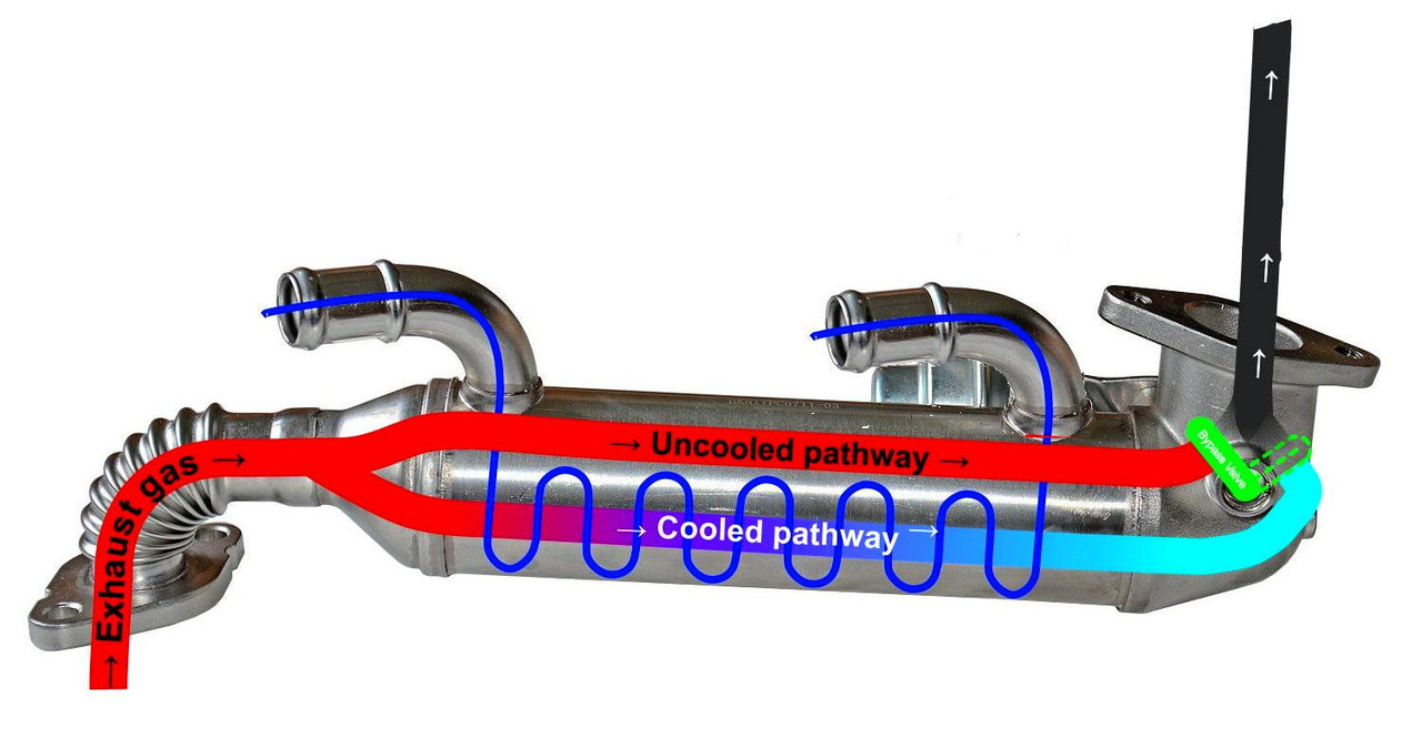

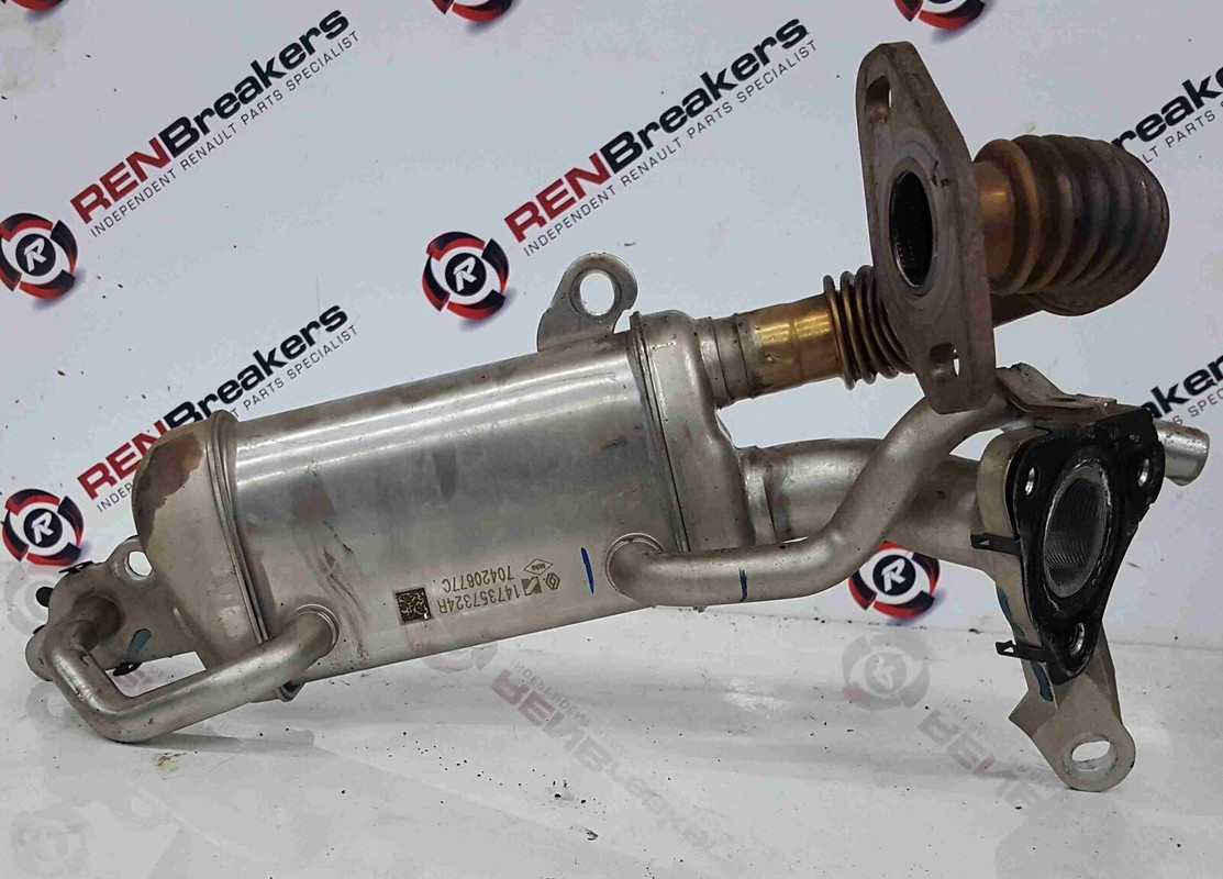

I’m in two minds at this moment whether to fit my Chinese diesel heater inside my garage or outside If I fit it inside my plan is to also use a EGR Valve Cooler (as fitted to a few cars & vans) on the exhaust pipe And piping in a car rad and header tank, this will add extra heat without adding further fuel costs (this image if from eBay, and this is selling for £18, used) On a car they work like this All that needs to be added to this setup is a rad, a header tank (expansion tank) and a 12v dc pump
Last Edit: Jan 6, 2023 7:54:25 GMT by mollydog1
I’m in two minds at this moment whether to fit my Chinese diesel heater inside my garage or outside If I fit it inside my plan is to also use a EGR Valve Cooler (as fitted to a few cars & vans) on the exhaust pipe And piping in a car rad and header tank, this will add extra heat without adding further fuel costs (this image if from eBay, and this is selling for £18, used) On a car they work like this All that needs to be added to this setup is a rad, a header tank (expansion tank) and a 12v dc pump I like that! Don't know how prone to getting clogged it would be though? If you set it out correctly it should thermosyphon so should work without the pump. Any idea how much heat you would extract that way?
