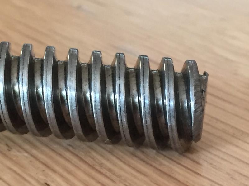

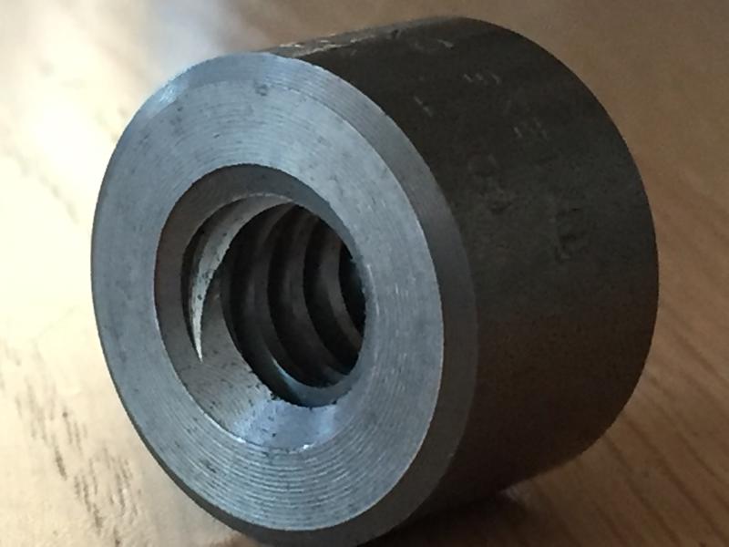

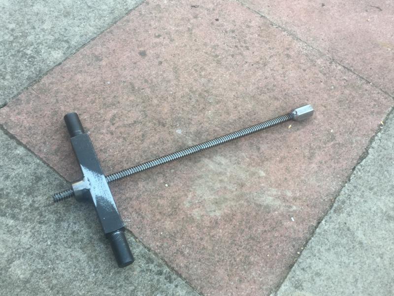

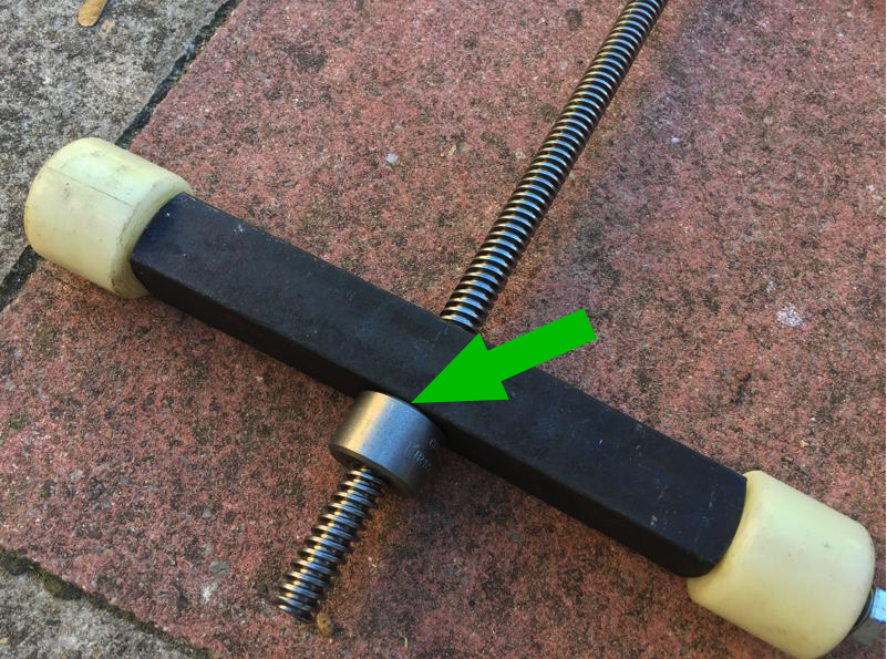

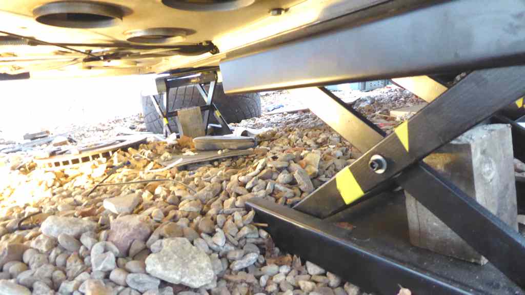

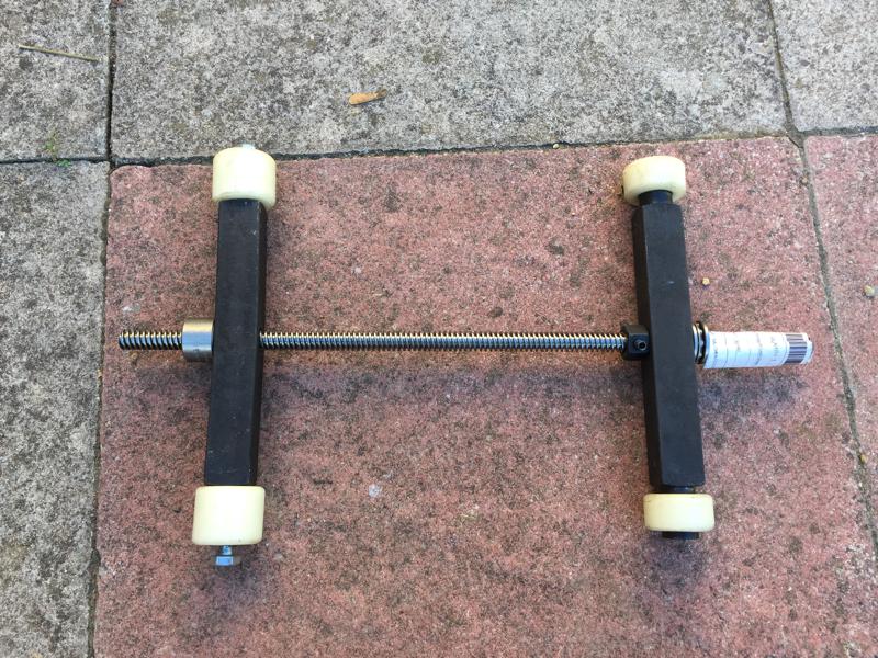

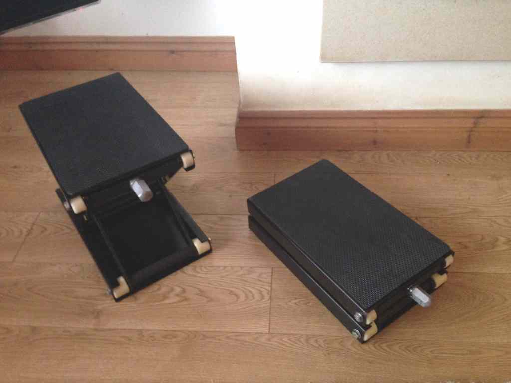

a few years back (maybe 2) I bought myself a couple of thee motor bike lifting stands off eBay, these are meant to lift up to 500Kg each, as my Lotus is only around 800Kg I found that using one on each side of the car I was able to lift up the Elise enough to slide under the axle stands,

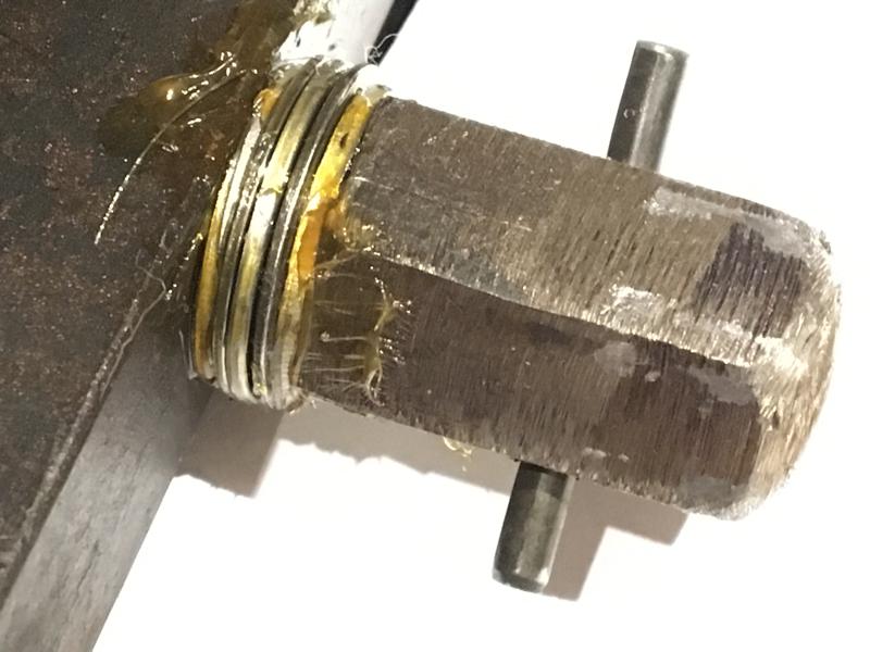

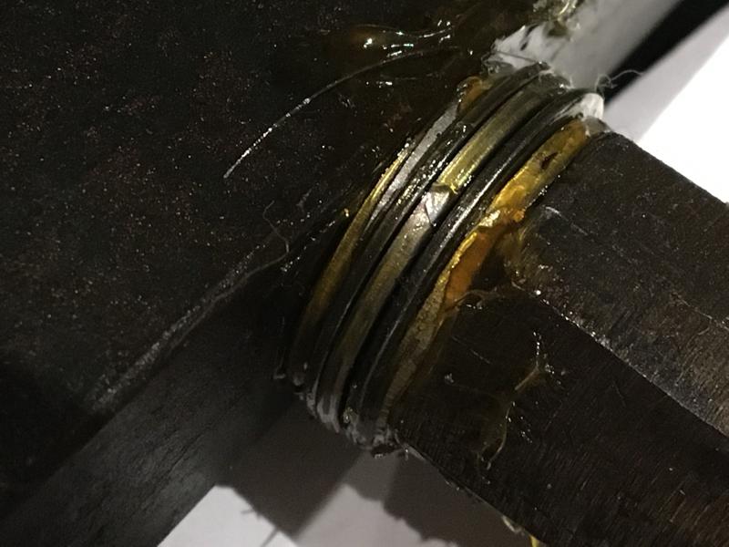

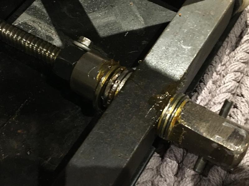

after some time I beefed them up a bit, as these were built to a price, so I bought new (better, stronger acme thread rods and welded acme threaded nuts at the ends and also fitted better thrust roll bearings I used to use a Dewalt 14v cordless drill with these bike stands to raise the car, this drill has approx 40Nm of torque, but slowly I was knackering this drill, so seeing on youtube others making use of a wiper blade motor for the same purpose I modified one out of a Freelander, it worked OK for some time I had it with two speeds too, eventually it started slipping, so to my question, as now I’m about to be replacing my 14v Dewalt cordless drill, what should I be looking for in a cordless drill that will have the torque/capability to be able to raise these jacks with car? I have one of those 1/2” Lidl impact wrenches but I was told these impact wrenches are not advisable/ideal to use in this manner, any help will be most welcome
