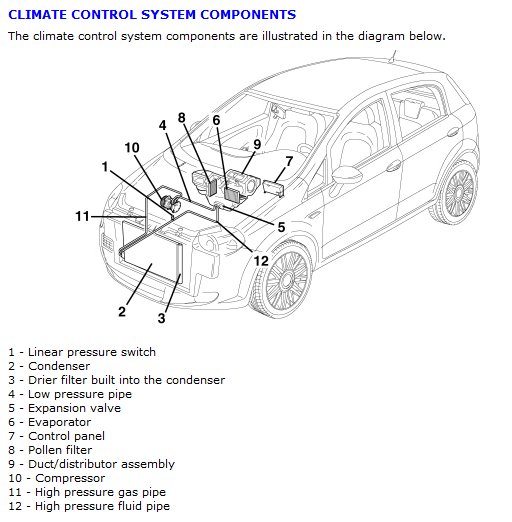

They wouldn't have put any gas into the system, they would have checked it to see if it would hold a vacuum first. The dryer unit might need replacement if damp had got in.
May 23, 2020 18:33:27 GMT
They wouldn't have put any gas into the system, they would have checked it to see if it would hold a vacuum first. of course I assume theres no way of checking that, wherever it may be.
May 23, 2020 20:53:37 GMT
Not really, they aren't expensive to replace though so worth doing if the system has been open for a while.

If you decide to renew the condenser you would be better off renewing the seals aswel, you need to use the correct seals not some random rubber o rings as these are not suitable and will fail over a short period.

have put that on my watch list need to get bumper off first and have a good look to see what I need, looking at my CD Manual the drier is part of the condenser:

If you decide to renew the condenser you would be better off renewing the seals aswel, you need to use the correct seals not some random rubber o rings as these are not suitable and will fail over a short period. will do, its the green type I have seen them before, even halfords sell them in a mixed pack but it will be another ebay item I think.
