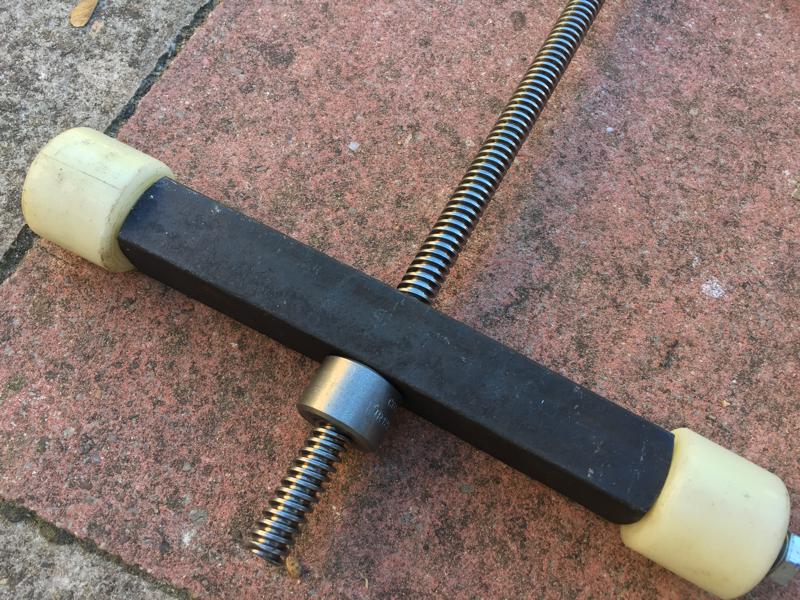

anyway I bought some Carbon Steel C45 Trapezoidal Lead Screws to replace the weak ones that came with the jacks
and nut
this was how I planned on welding the nut
welded this on one end of the Acme thread rod

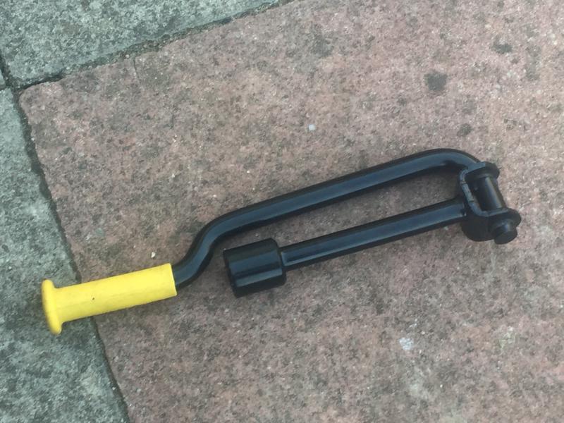

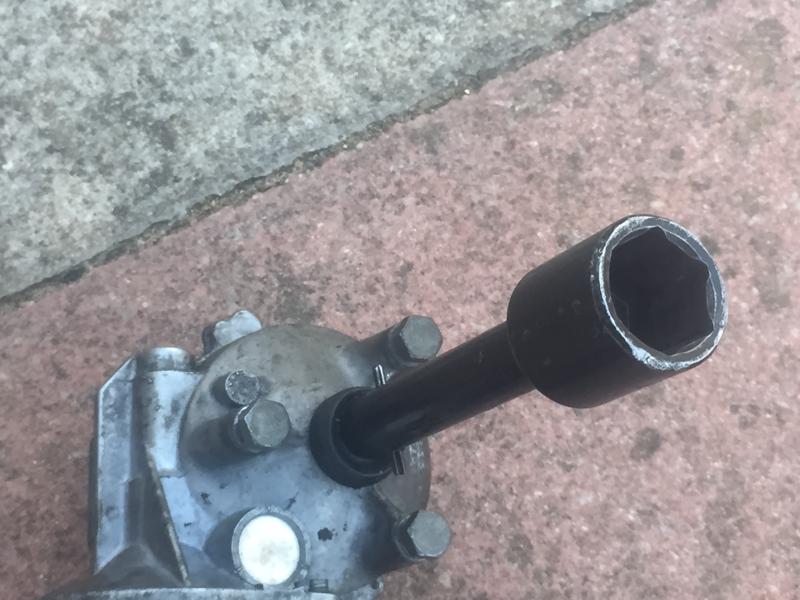

as for turning the wiper motor in to the scissor jack more
I cut this jack handle off to use on my wiper motor

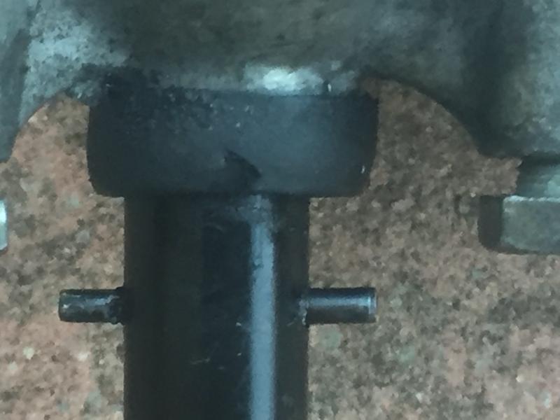

and a pin to keep it from unscrewing
