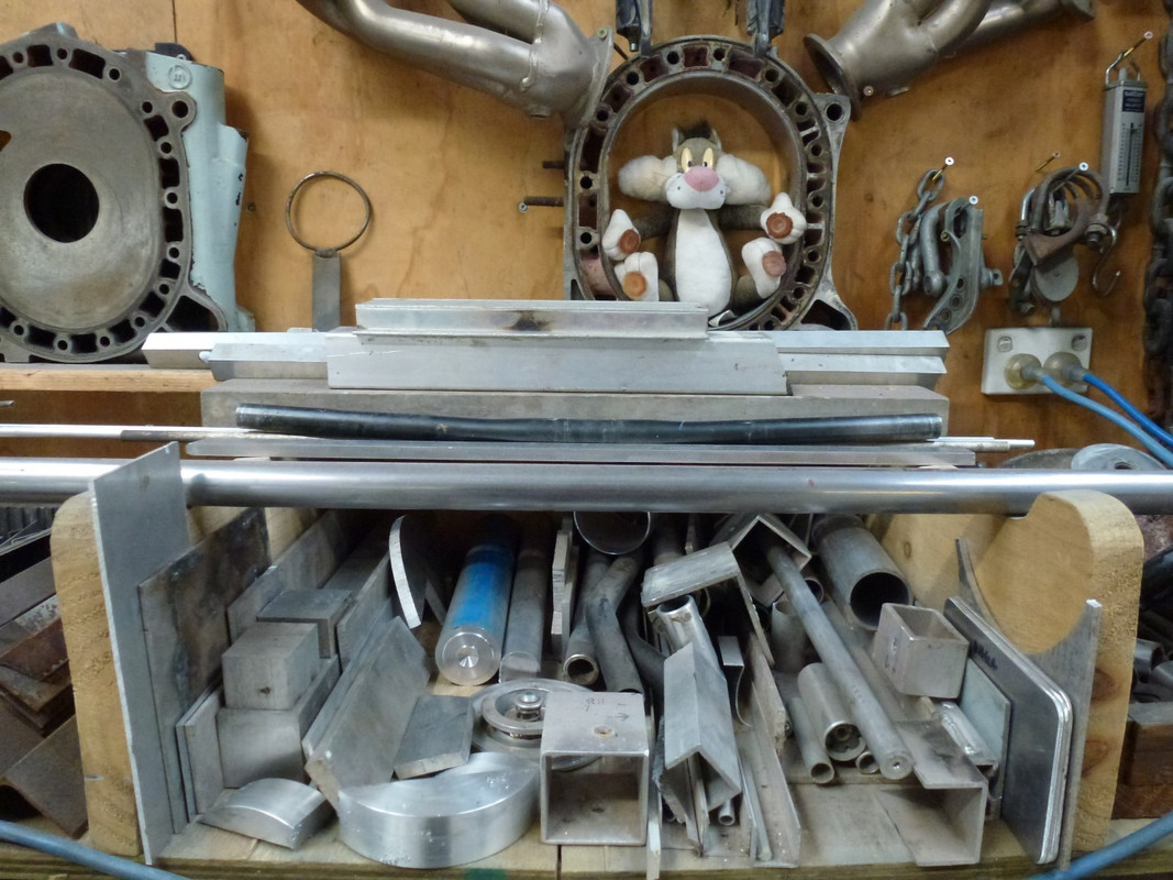

So keep it simple with stuff I have to hand! With that I rummaged through the pile of alloy stock I had and found a few bits that would work...
