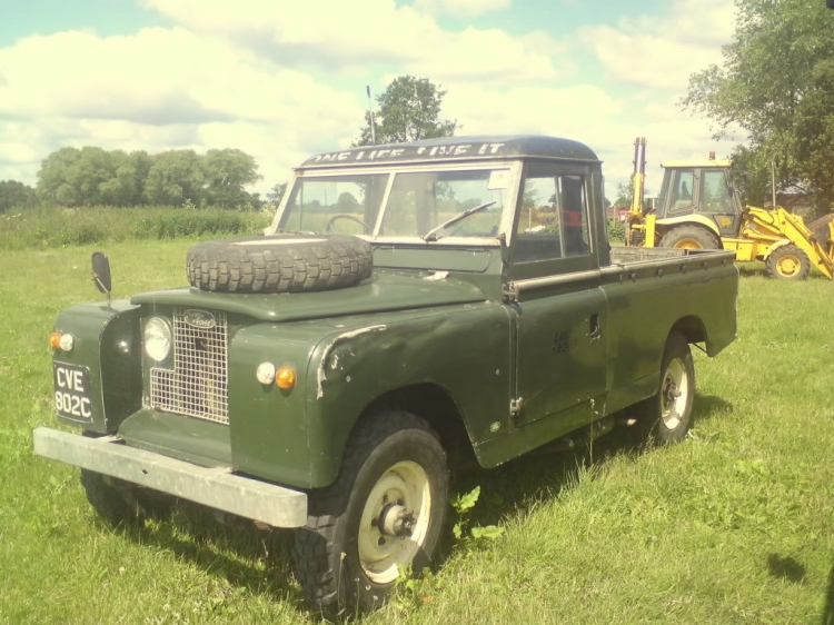

Long time lurker, first time poster here. Id like to introduce CliVE, my 1965 built Land-Rover. CliVE was my 21st birthday present, purchased sight unseen from Evilbay in 2009 This is how things looked after a galvanised chassis, bulkhead and front panel rebuild in 2011/2012 with lots of help from friends far and wide! Fast forward a few years and we are now running a 200tdi with a 5 speed gearbox and a P4x4 giving a reliable 35mpg at motorway speeds During the dreaded C19 lock down it became clear that my wife and I wanted to share our love of travel and adventure and rather than selling CliVE we decided to convert him into a 2 and a half person camper due to the arrival of our little boy. Plans were drawn up, metal was aqquired and a lifting roof was fabricated and fitted on my drive at home. Best decision ever! Sorry for the length of the thread but I hope atleast someone found it interesting. My wife and I are constantly trying to improve things and power steering is the next big improvement I’m gathering the bits to complete. Pete-with-a-V

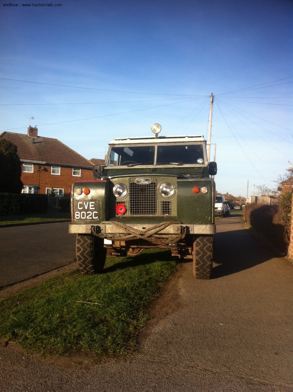

Not the best photo but we have a swing out awning that I made out of the left overs from the awning extension build. It can be seen stowed in a number of the photos I’ve already posted. I’ve tried to make thinks look like they are supposed to be there. The engine change took place around 35k miles ago and has worked wonderfully (touch wood) The engine is a 200tdi with a 300tdi turbo to make exhaust routing a little easier. It’s mounted 3 inches further forward than standard and 2 3/4 inches higher. This was done using modified engine mounts from a standard series engine shown below Doing this means that the LT230 handbrake drum fits and can be removed if necessary. Although this itself has now been replaced with a more effective disc handbrake from Ashcroft engineering. One other thing of note that’s been fitted is the engine block heater to improve wear, tear and mpg on my short 20mins commute to work in a morning. Anymore and I’ll have to move this to a build thread not a showcase thread. Pete With-a-V
