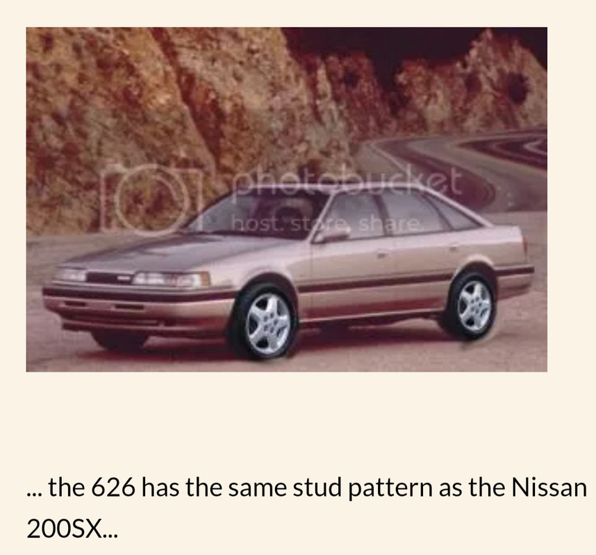

My Auto looked cool on Nissan 16" alloys.... *photoshopped Nice to see these pop up from time to time 👍 OVIMOR
