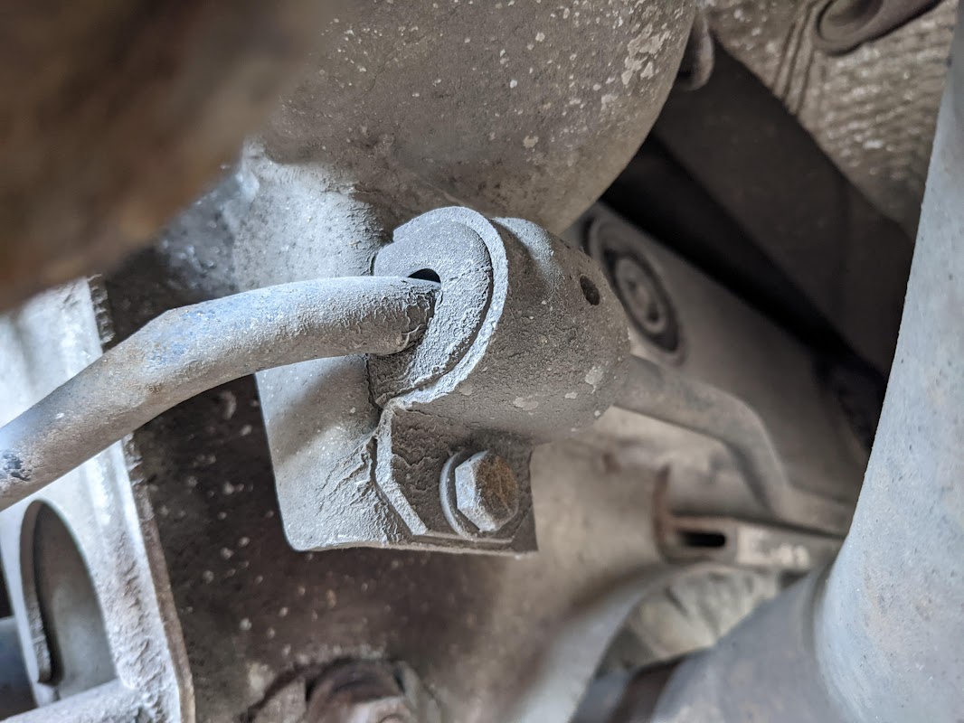

Front drivers side. This was one of the wheels that I'd found some play in before my test drive. Sure enough the bush on the forward control arm (closest arm pictured - passing over the tie rod) was totally shot. One arm to replace. Front passenger side - there was no obvious play in the wheel this side, but the bush for the front control arm felt far softer than it should - and it's good to do arms in matchin pairs anyway, so that's a second arm to replace. Moving back down the car, the next issue found was the guibo, the rubber damper in the prop shaft, just after the gearbox: Although not obviously bad at first, it's very cracked and is hopefully the cause of the lash in the powertrain. It's not so noticeable when pulling away forwards, but there's a noticeable clunk pulling away in reverse (guess who didn't reverse on the test drive), and a less noticeable jolt getting on and off throttle. In the same sort of area, one of the exhaust flexis has a small hole - I was forewared of this one from the previous MOT advisories though. Heading to the back:
The offside wheel actually felt all good, but the nearside wheel had a lot of side to side wobble - which was the other bit of movement I'd picked up pre test drive. This one was due to a dead ball joint in the upper front arm, which looks like it controls the toe. Arm number 3 to replace. I know I should do them in pairs, but I just don't like this car enough yet - I'm fixing the urgent bits and seeing how it goes!
More parts ordered: Pair of front arms, one rear arm and one guibo - all Meyle as i'd much rather buy a good part and not have to do the job again 6 months down the line... I have since realised that Lemforder is the OE manufacturer for all the suspension components - so in the future I'll probably opt for them instead.
The tyres got fitted one axle at a time in the end due to the garage being busy. Fronts were fitted, only to find one of the wheels was slightly bucked - although they managed to balance it with over 130g of weights... Driving with the new front tyres removed a lot of the vibrations at speed, but not all of them. You could no longer feel them through your feet in the front footwells, but now it was felt more through the seat. Suspecting that I might have a buckled rear too, I asked them to check when they fitted the rear tyres, and if one was buckled swap it for the spare alloy. (So nice having a proper spare wheel - the mazda 6 doesn't even have a space saver, just pump and goo)
Sure enough, the car came back wearing the spare wheel, and a slightly buckled, newly spare wheel in the boot. I guess we know why these wheels went into the shed in the first place!
All tyres swapped and balanced, the car drove far better - nearly all the vibration gone. That's a relief!
Between the front and rear tyres being done, my new rear control arm arrived so I fitted it one evening:
The recommended approach is to use a pair of needle nose mole grips to hold the balljoint still while you take the nut off - mine was far too seized though and I resoted to the junior hacksaw and a clout from a cold chisel to get it off.
The old arm was BMW marked, so either the owner at the last suspension refresh spent good money on it, or this is it's first replacement at 160k - which from the reputation of these cars I rather doubt.
The new arm reduced the vaugeness and clunking at the rear significantly, but didn't fix it by any means. It took me a few more days to work it out, but when it was on the ramps the rubber thing that looked like deteriorated boots on the lower rear arm had looked knackered, but I hadn't found any movement with a pry bar, and hadn't understood how the suspension went together at the time.
That severely deteriorated and out of line thing is actually an in line ball joint, which I had never seen before, and it's supposed to be very much inline with the bolt. Ah. Symptoms of a dead lower arm ball joint are tyre wear on the inner edge, so I guess that would explain the extreme camber on the rear, clunking, and sidways movement over bumps. Tick, tick and tick. I only realised this a few days after swapping the rear arm, so lemforder ball joints and an extactor tool are in the post to me at the moment.
The front arms arrived in time to be fitted by the garage at the same time as the rear tyres - very rare for me to not do something myself, other than tyres at least, but I've been feeling a bit pushed for time to get this car dailyable driveable.
All in all, with new tyres and the worst offending arms taken care of the car is far better to drive. It's now pretty comfortable at motorway speeds and much more composed in corners, but the back end is still unpredictable and clunky, and there is a smaller knock I can hear from the front now - my guess is droplinks or shocks... It also really needs a geo, but no point in doing that until I've at least replaced the rear ball joints.

Yep, I think this is a little bit dead! The special £25 puller I bought on ebay was employed: It took a lot of abuse to get the ball joint out! Long breaker bar on the puller to wind up the pressure, then breaker bar off and thwack the socket with a lump hammer. Rinse and repeat for about 10min before it finally falls out. Absolutely no way I could have done this in situ without the special puller! This is by far the most knackered part I've ever pulled off a car. The ball has about 10mm play in the surround, it's actually worn half way through the ring on one side - straight through the boot mounting lip. I cleaned up the mounting hole, gave it a smear of grease and pressed in the new Lemforder ball joint with no issues That in, everything went back together painlessly enough... lets see the before and after:
So much better!! The other side went a fair bit quicker, both sides taking about 2.5 hours including a couple of dive for shelter/coffee breaks when the heavens opened. On a quick test drive I could feel the difference literally as soon as the clutch bit - the little clunk and movement from the rear when pulling off was gone. I then aimed for every drainage cover and the rear no longer stepped out of line at all over any of them. The rear also follows you nicely when you take a turn and the ride has improved massively - If I didn't know better I'd have thought the rear shocks had been replaced too.
That all being said, there is still a good clonk from the rear somewhere and the handling still feels far from tight. Part of this could be a couple of things I picked up wile I was doing the ball joints... The dampers still have gas pressure in them, but the damper body spins round on the damper shaft with no friction at all, and the ARB bushes were looking a little past their best - actually they felt like they were made of soft foam!
I'd already figured that the dampers and ARB bushes weren't in good shape and ordered them a while ago. I've been a bit hesitant about ordering parts from the EU since we regained our sovereignty after that raft of horror stories earlier in the year, but it's so much cheaper than UK sourced parts, and so far it's been totally seamless - I have a full set of OEM Sachs dampers waiting to be fitted from German eBay sellers, and a big order of top mounts, droplinks, spring isolators, spring aids (aka bump stops), damper covers and ARB bushes is on it's way from Autodoc. I will get this car's ride and handling back up to scratch!
