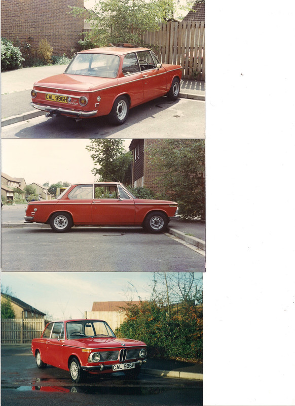

I had one a few years ago, before they got very expensive. Mechanically they are pretty straightforward, parts are easy to get and much of the mechanical bits carried over to the 3 Series cars (although they are now getting harder to find). Engines came in 1600 and 2000 I think from memory (mine was a 2.0). This was it..... Rust was the biggest problem - particularly in the boot - the tops of the rear shock towers were completely rotten on mine when I sold it. On the plus side - prices are rising fast, so if you can get it for anything close to a sensible amount I'd snap it up if I were you. They drive well, look fabulous and are easy to make go sideways when you want them too. Interior is pretty minimalistic and functional, but a nice place to be.
