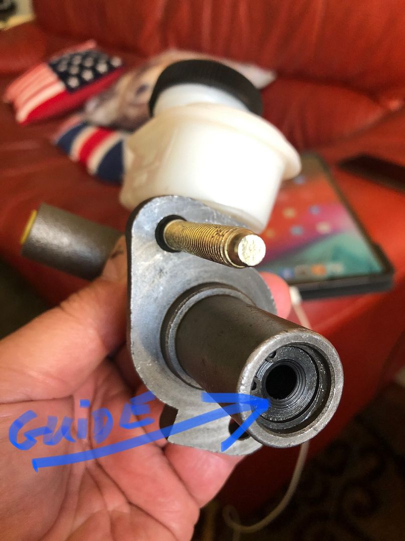

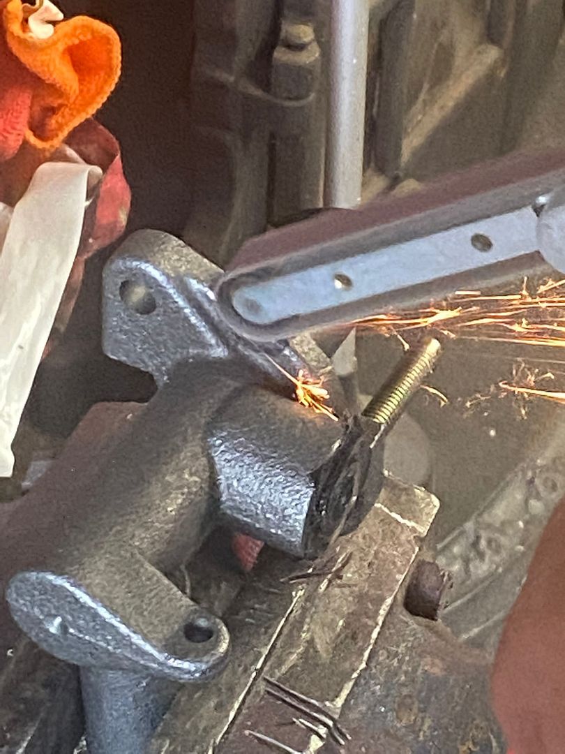

Mailman and EBay made me happy. New clutch Master cylinder came. Design is a bit different. First thing I noticed was the guide at the mouth of the unit where the rod enters to hit the plunger. It was not present on the other unit, for whatever reason. Hopefully it is a quick fix tomorrow morning. Would be nice. At least the weekend has landed, heat predicted so be careful out there. .
Aug 12, 2022 19:35:45 GMT

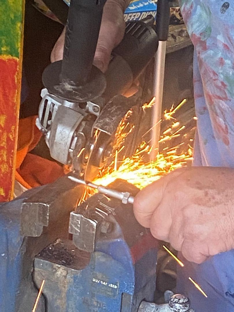

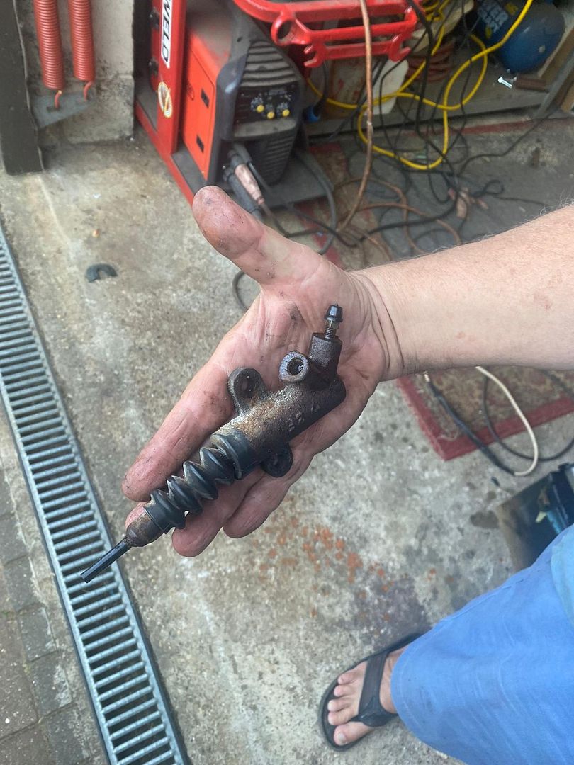

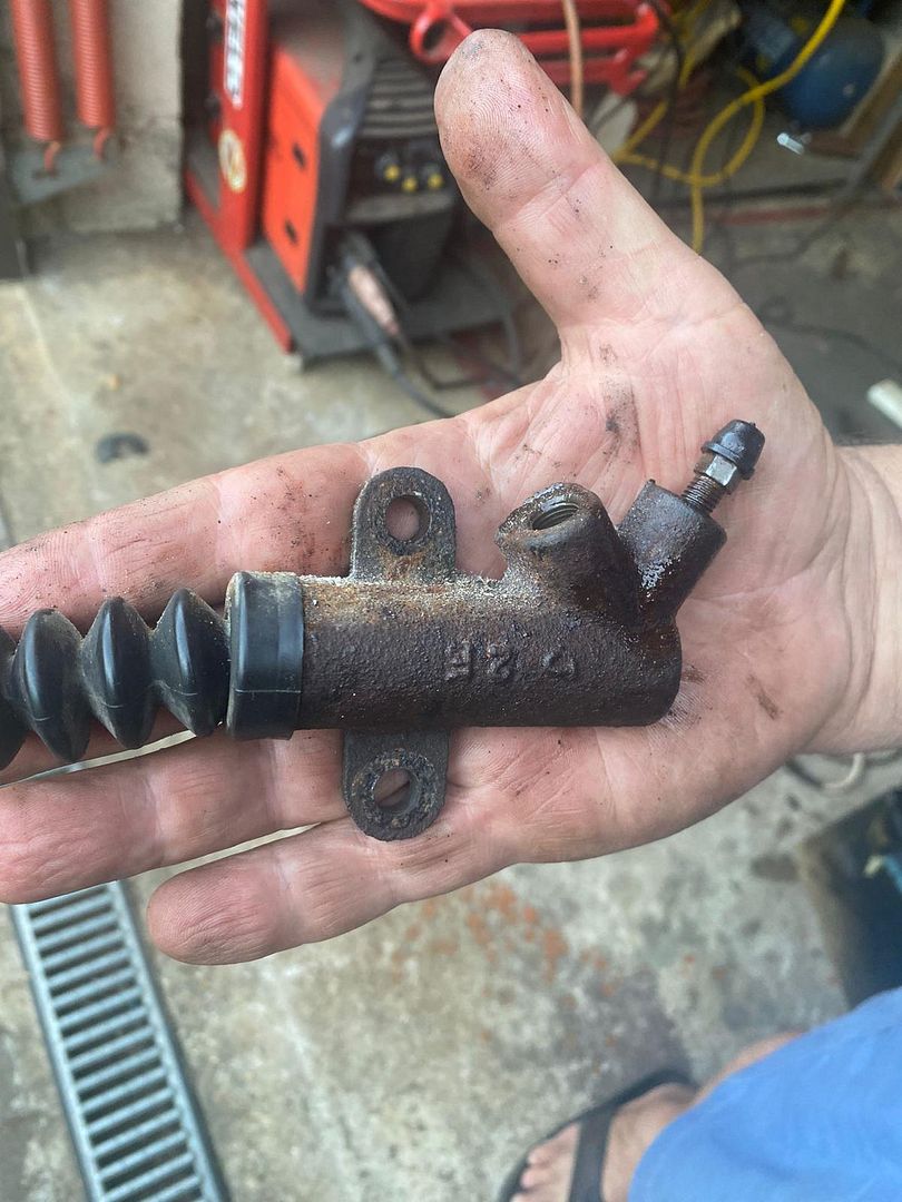

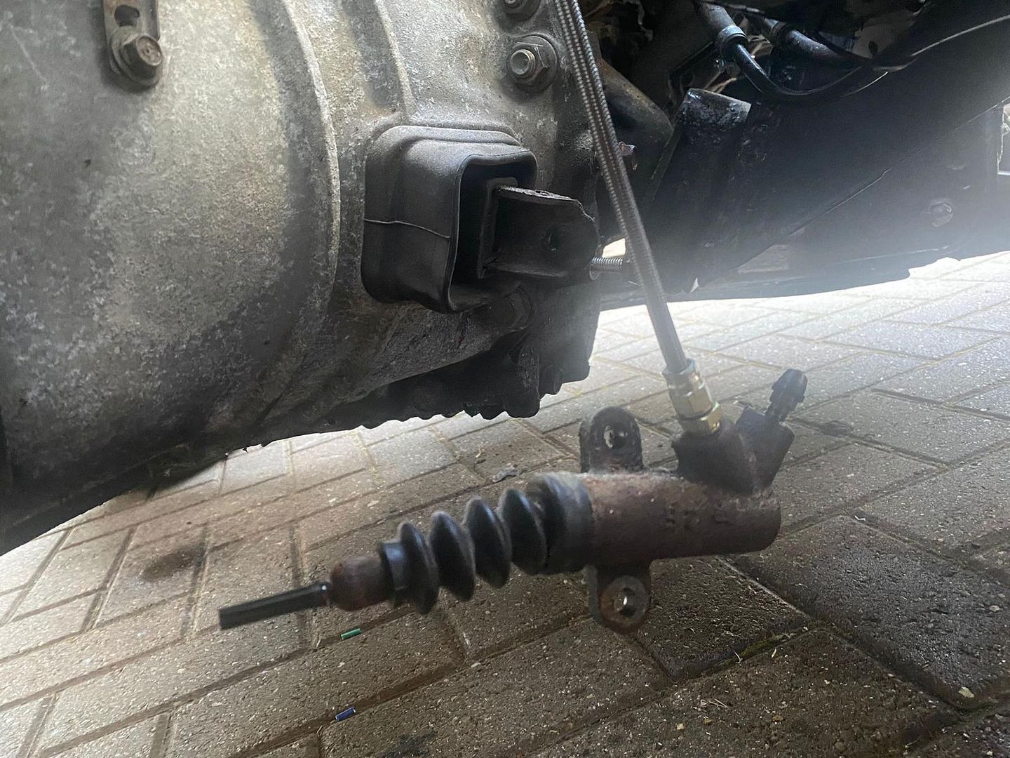

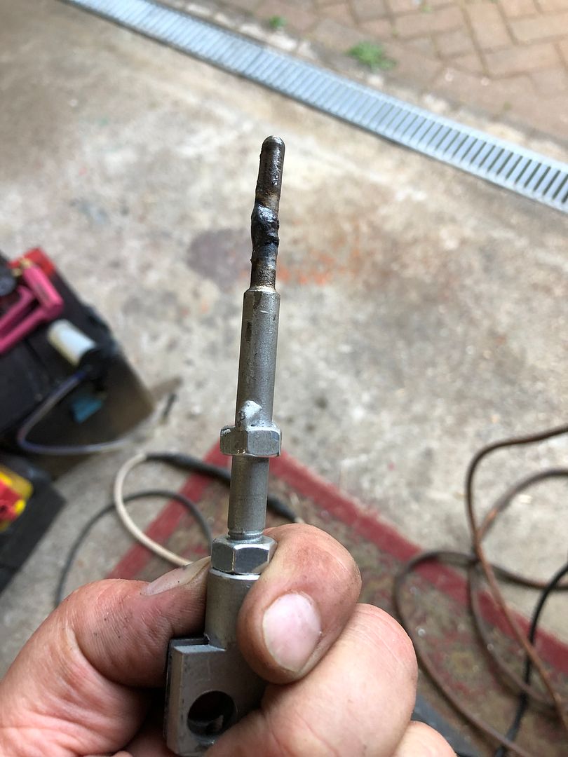

So the first job back home tonight was to cut the new MC and grind it to fit around the brake booster mounting foot. Clevis fitted, clutch pumped and bled….. Car started, 1st and 2nd engaged with the rear in the air. Brakes tested, clutch tested some more, clevis adjusted, still not quite right…. Shortened and found to not be quite right. Called out Mr Grinder…. Refitted. Perfect, gear change smooth……. Till it went PoP ! Dismantled, and rewelded. Refitted, works well, clutch pedal too high…… And POP it went leaving the clutch fixed in a position. Removed the Slave cylinder, and clutch back in position, wheels turning freely etc. And yes, cleaned up, ground back tidy. So I removed the Slave cylinder completely and will be buying a new one as nickwheeler had suggested in the first place. Lets see what the spares shops have in stock tomorrow. Hanging loose with the Rezin Rockit. And removed. So clutching at straws. While I have other stuff to deal with. Friday night . Drink??

You might need a stop on the clutch pedal as well as the throttle. The clutch slave cylinder doesn't need to move very far. And it's very easy to push both too far and do some damage. as for shortening the pushrod, you do like doing things the hard way
You might need a stop on the clutch pedal as well as the throttle. The clutch slave cylinder doesn't need to move very far. And it's very easy to push both too far and do some damage. as for shortening the pushrod, you do like doing things the hard way Absolutely agree. Already planned. And yes, my bad, but it seemed the right solution at the time, and felt like it once re-installed. Still, I would have preferred not to have done it. Replacement Slave ordered. £13.90 and two day delivery.

A small hint to save you some frustration: fit the clutch hose to the slave cylinder first, bolt it to the gearbox, then attach the swivel fitting to the master cylinder.

A small hint to save you some frustration: fit the clutch hose to the slave cylinder first, bolt it to the gearbox, then attach the swivel fitting to the master cylinder. Agreed, I actually did everything in reverse and it worked beautifully. Done.
