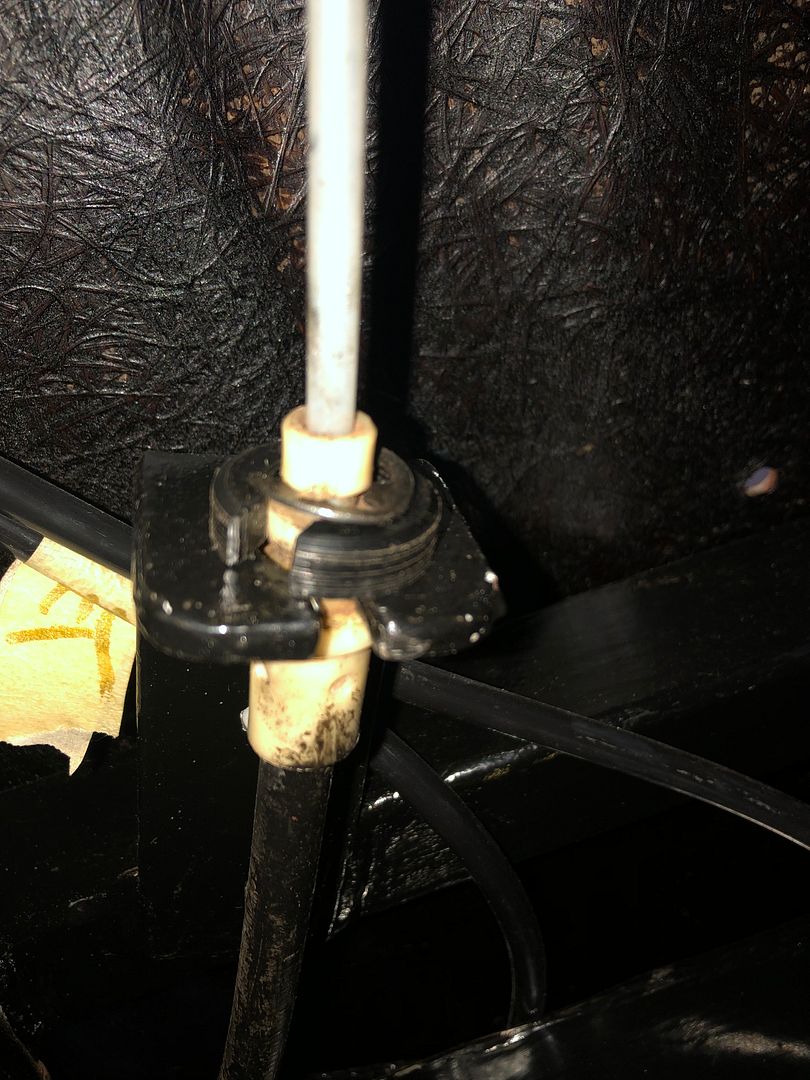

So in preparation of possibly dismantling and dropping the fuel tank to get to see the wiring, I lifted the rear end, again. I’m wondering how many times this thing has gone up and down since it got here. Anyway, another small job done. Fitted the handbrake cable spacer Nick turned for me from some Nylon he had, added a circlip and hey presto….. Next job will be to remove the wheels, AGAIN, and set the handbrake and pads to a level where it is functional for the MOT test. Weekend almost over. Need to go find something in the garage though.

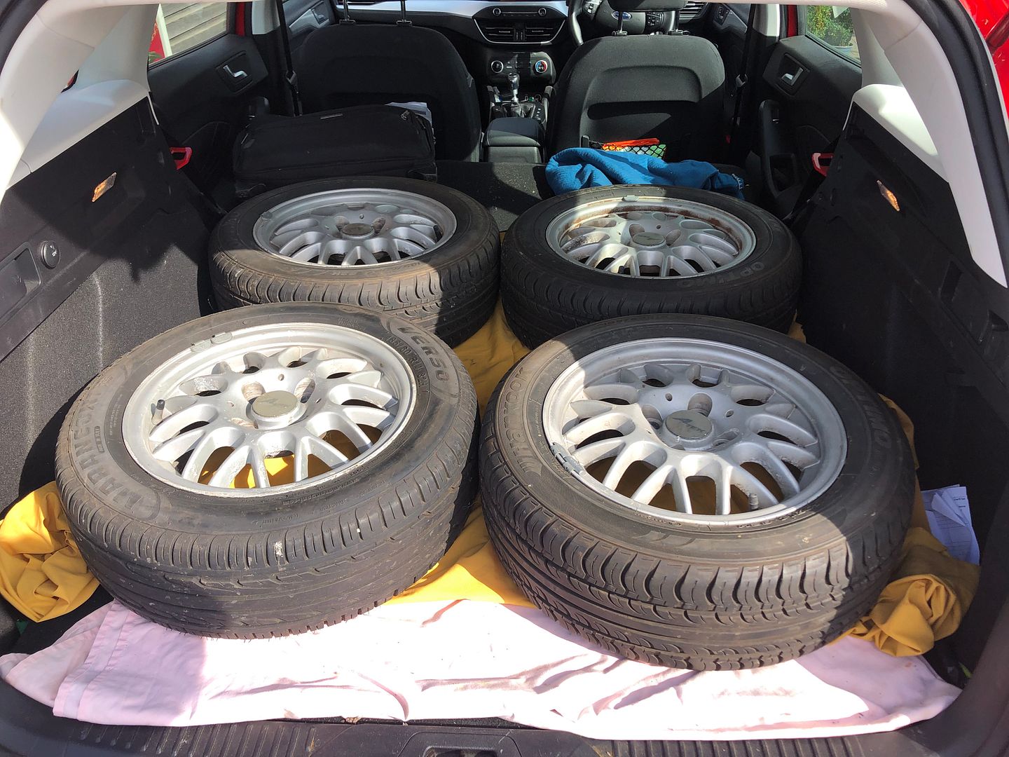

Thanks to redratbike for selling me these 4x100 wheels in 14” size. I have something in mind for them. Wheels make me happy. Ohhhh, and it is the weekend. Beer time.
Thanks to redratbike for selling me these 4x100 wheels in 14” size. I have something in mind for them. Wheels make me happy. Ohhhh, and it is the weekend. Beer time. another project in the making
Thanks to redratbike for selling me these 4x100 wheels in 14” size. I have something in mind for them. Wheels make me happy. Ohhhh, and it is the weekend. Beer time. another project in the making Just getting these wheels cleaned and painted will be a project in themselves. Imagine them on the Rezin Rockit, wider tyres, detailed, painted and even lower than it is now….. Thanks to westbay for poking his fingers in my wallet like Paul Y does…… I now have some of these badges headed my way. Certainly apt for this build.

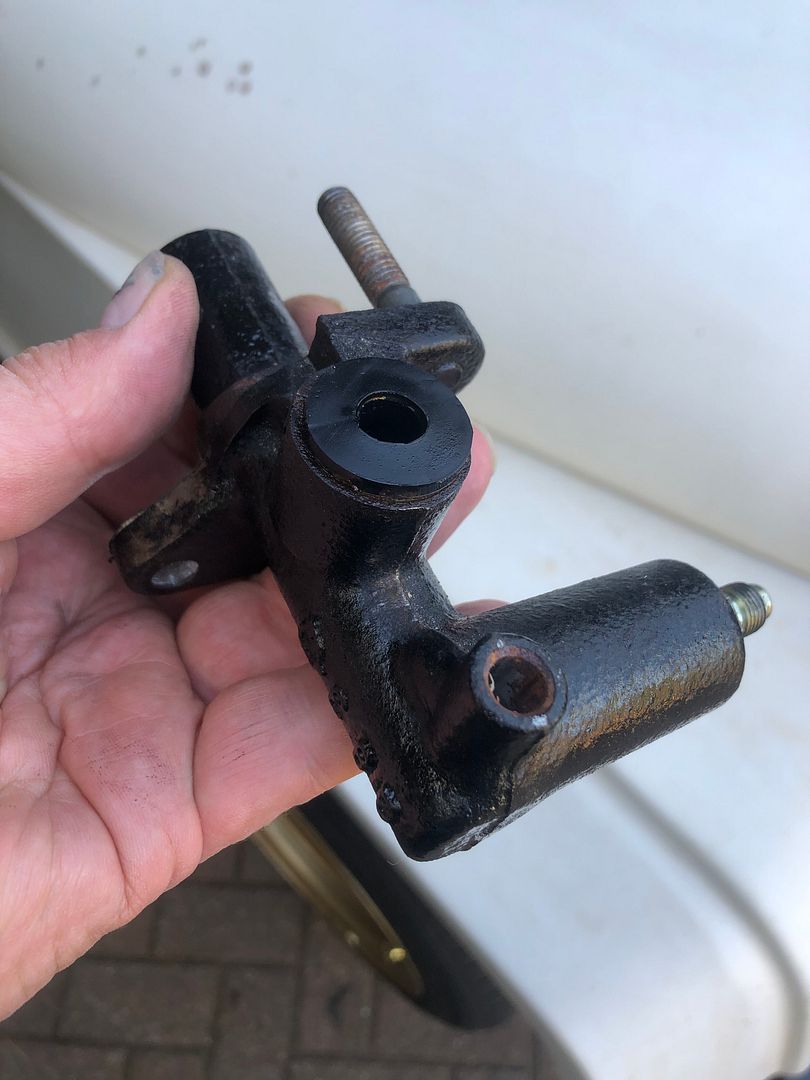

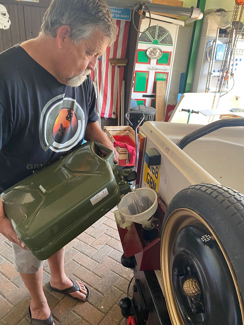

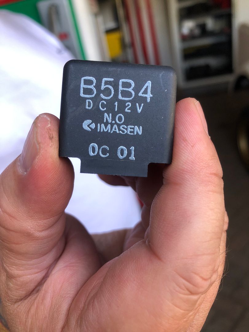

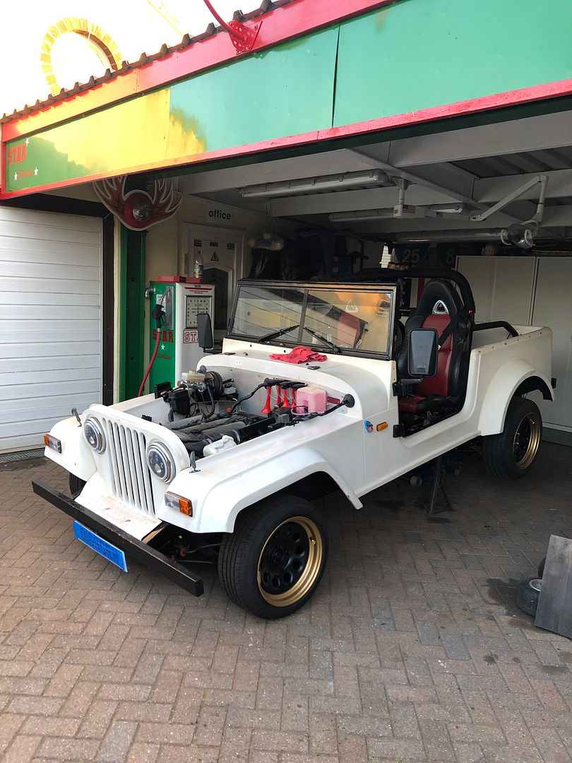

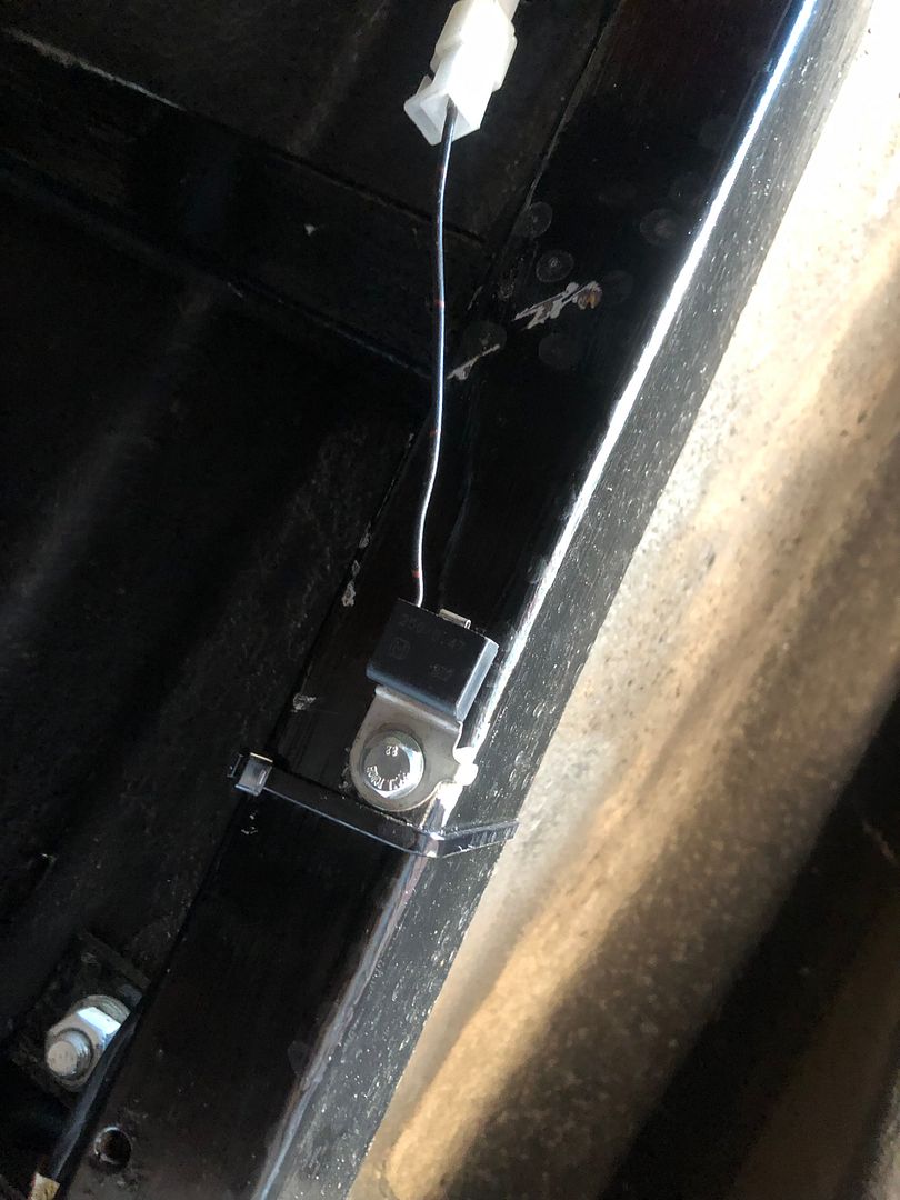

Few small tweaks today. I actually drilled and tapped another earth…… After more digging around we found that the fuel pump relay was not working correctly, so John bridged it and it fired right up. More testing after opening it up showed it could be closed and be made to work. So a brilliant bodge installed, closing the switch permananetly. I need to get a working MX5 relay like this to replace the fitted one. So then 20 litres of fuel into the tank, and a small prayer we turned the key. And after all the ups n downs, it fired up, lumpy at first then settled into a idle. Revving it up reminds me of an Alfa Giulia when I was growing up. Once over the jubilation, trying to get the heater/blower fan going was a major fail………. To be revisited another day. Next job was to bleed the clutch master cylinder. Lots of murky brown fluid. Failed to get it sorted as well. So I took the MC off and inspected it. Looks like a replacement may be due or recommended. I am guessing it is an original Ford part though.
