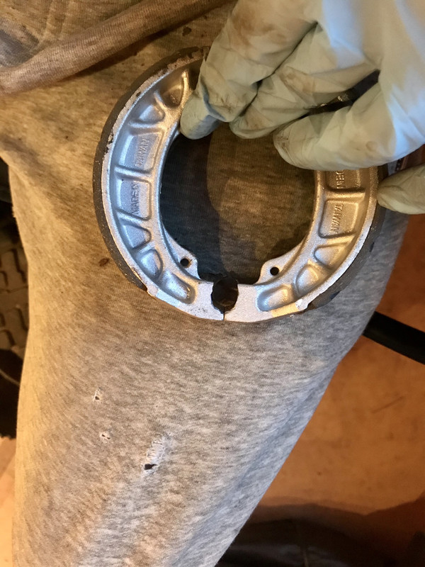

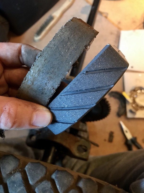

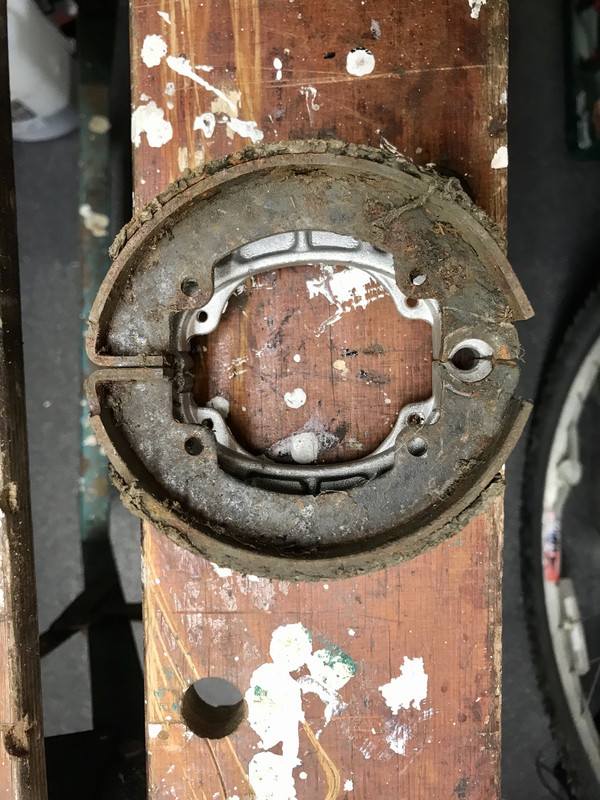

Did the brake tonight. Haven't worked on a drum brake before so it was all a learning curve. Because parts for this are not very off the shelf I had had to make an educated guess at what brake shoe might feet. These are for a moped I think. Either way they have more meat on than the originals. And grooves. Nice. Test fitted them and they would not go back in the drum. Had a look at the two together and saw that they round bit was smaller on these than the original. Decided to try using a jigsaw to open out the hole a little bit. Missus was not impressed at all as it woke the baby. It worked though Very pleased with that I came back up the garden to find I'd been locked out and she'd gone for a bath.
