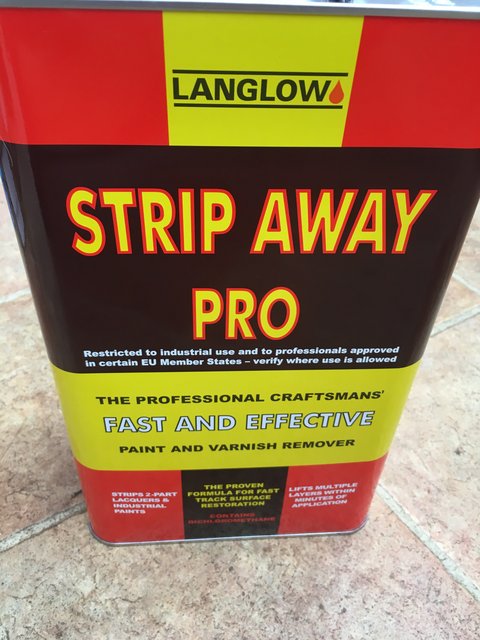

I’m in agreement there it definately isn’t as good as it once was See Nitromors (spl) for similar statements along the lines of a “shadow of it’s former self” I mean it used to actually bubble up the paint - any paint!!!! Ever since they made Nitromors environmentally friendly it also became paint friendly. I've just got some of this.  I replaced a fence which was 40 years old with exactly the same - if it lasts another 40 years I’ll be happy (also very likely dead - 56 now) You will be huffing and puffing replacing that when you're 96.
