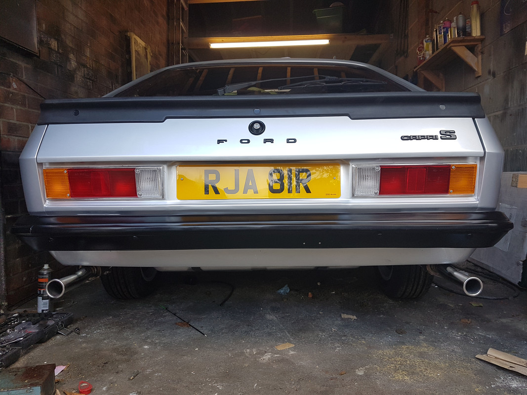

Ive tried chrome spray in aerosol form and it looks good but stays very soft.if u even wash the bumper it will mark it.no good to be honest.nice capri mate.i have a mk2 3.0s and my bumpers are black.sand em to death.prime them then satin black.il try get a pic up
tazla
Posts: 72
Apr 18, 2019 17:48:09 GMT |
Here you go
cjhillman
1979 Capri (Rolling Project) 1985 Escort mk3 (Daily)
Posts: 1,137
Apr 18, 2019 22:23:21 GMT |
Here you go  Beautiful car mate! I do like this look . I think i'm trying to make mine a subtle hybrid of a mk2 /mk3 without knowing it. Love the front of the mk3 but back of a mk2. I'd love a mk2 grill for the front but cant find one at a normal price! I like them too mate but they're so expensive at the moment I think i need to use that money on the rest of the car at this stage. loads of little things to do. I thought it might be easier to tie the front in to the back chrome bumper at this point.
