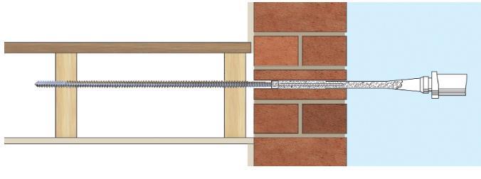

From what you've said I'm reminded of old barns and a few buildings where, to stop the walls bellying out, they put iron rods all the way across with a big cast spreading plate on the outside. Dear old dad told me that in barns they'd wrap straw round the bar and set it alight. Once the bar was hot they did the nuts up so as it cooled it pulled the walls in. Don't know if that's true though.
