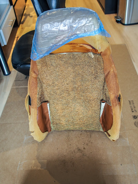

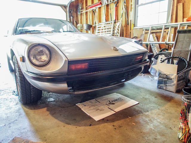

Seats and BumperThe bumpers finally arrived, about 7 weeks after ordering them. The company only sent one set of mounting hardware, but whatever. I'm never using them again. The initial fitment was terrible - one side looked like this: The other like this, with a nice 2" gap: On the rear of the front bumper, there's a bracket to mount it with: There was no way I could physically get my fingers behind that. Frustrated, I left and decided to head back another day, and sent some emails to the supplier. They didn't respond, cementing their place in the "never use again" bin. Today, I figured I'd have another go at the front bumper. It felt pretty flexible. With some cable ties holding it in place and slowly pulling it into position, I was able to get both ends tight against the car: Much better, although not exactly the flush fit I was hoping for: During the last couple of weeks, I've also recovered the seats. Take one seat, undo all the bolts: Strip off the old upholstery and try not to breathe anything in: Put the new on and secure in place: Do the base: Repeat for the other side: Much better. They're back in the car now, but I don't have a picture of that. The final thing I'm waiting for is a new steering wheel. The hub arrived today, so I decided to tackle removing the old wheel. In my MX5, that took about 3 hours of constant pulling, pushing, levering. In the 280Z, I rattled the bolt off, gave the wheel a tug and... That's the new NRG hub with a Momo bolt pattern, just waiting for the new wheel. You can also see the new Joyfast knob fitted in this picture, and some of the seats!
