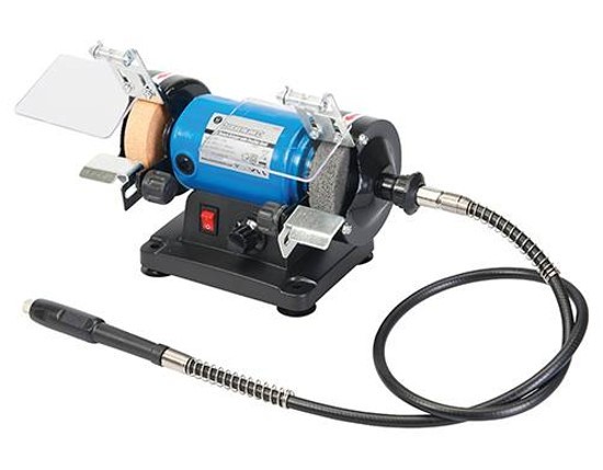

Lets start with some recap pics. There i was busy doing this 20161017_201850 by logicaluk, on Flickr When this fell out my clarke rotary die grinder thing. 20161017_201939 by logicaluk, on Flickr Which stopped me but at least i found my mojo. Ive ordered a silverline mini bench with a flexible drive shaft Which should see the head finished, but thats not here yet so today barry came over to help so lots got achieved. More rot removal was the name of the day and we nearly got all of it, barry got the really tricky inner cill and floor pan rot cut out. 20161022_161949 by logicaluk, on Flickr Whilst i did the job that's been scaring me since I started, remember this? 631bb5f7620c by logicaluk, on Flickr I cut these out 20161022_181930 by logicaluk, on Flickr Leaving this. 20161022_142924_001 by logicaluk, on Flickr] And this 20161022_155323 by logicaluk, on Flickr Which i cleaned up and typically forgot to take a pic, but luckily barry did IMG_20161022_220626 by logicaluk, on Flickr IMG_20161022_220622 by logicaluk, on Flickr So now there's only the front valance left to derust. Ive got a half cut acclaim that was going to be made in to a camping support trailer but now will have to give up its intended use to save frank. Dan
