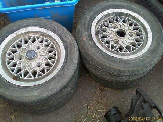

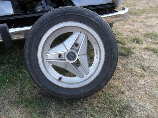

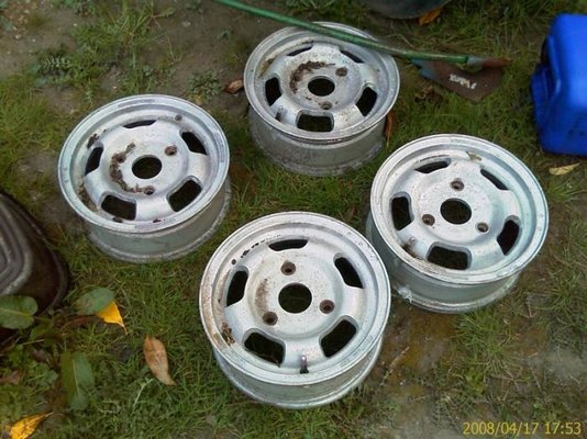

Try this 'for sale' thread on the 'Friends of the Renault 15 & 17' forum - there's 51 pages of (mostly) 3x130 wheels there. Here's a few examples: M.A.S.: Targa: Another Targa: Dunlop 3-spoke: A nice set of chromed R8/R17 steelies: Try googling 'jantes 3 trous 130' (wheels 3 holes 130), it should get you a few results and it should work on ebay and leboncoin as well. There is a French company called Delta Mics who were a bit like Ripspeed or Demon Tweeks. They used to sell their own wheel designs and resell wheels from other suppliers under their own name as well (they only sell quad bikes and wheel spacers nowadays though). It's worth searching for Delta Mics, I like this design of theirs which pops up fairly often on that thread, and seem to be mostly seen on Renault 8 Gordinis: They also did these mesh ones as well, both in split rim and single piece designs: They also sold steelies, including some odd-looking multifit Weller-style 8 spokes and these super deep dish ones for the R8:
Dec 24, 2013 18:56:40 GMT
buzby: That's brilliant info! Those first Delta Mics, the Dunlops and the Targas are awesome, especially the Targas in fact. Looks like there is more choice than I'd expected out there.
