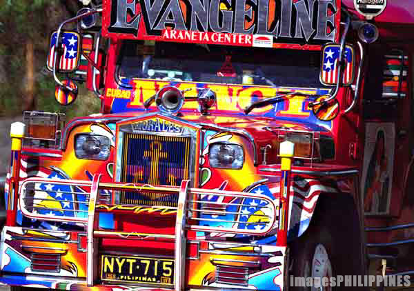

Could a curved suport with a cross brace into the top corner look softer ? Or even a thin steel or ally plate over the brace, to close it in, then decorated on the sides. Use the sice brace covered over, and curved with removable panel a bit like this.... use your very fertile imagination to transfer to your Hino. More like the idea.
